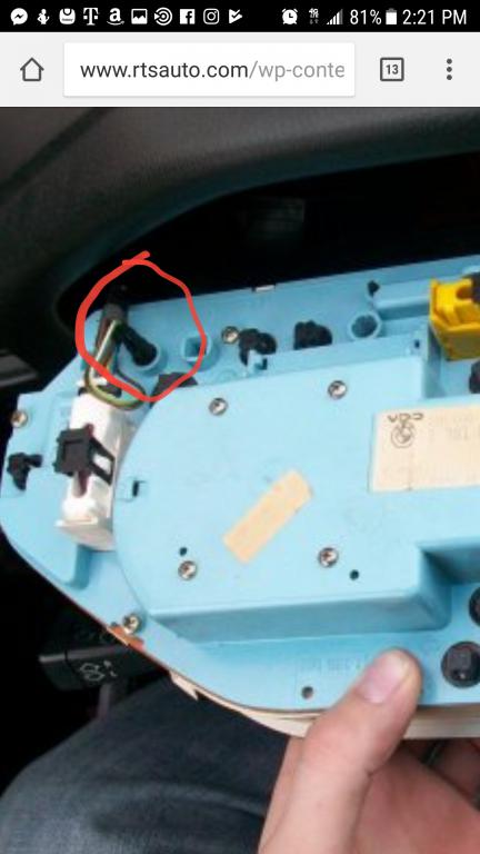

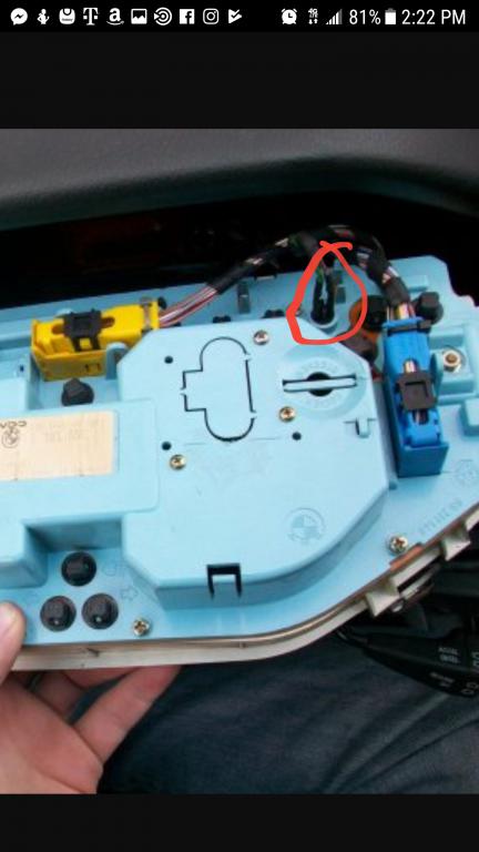

    Can't find part # for pronged bulb socket for gauge cluster.

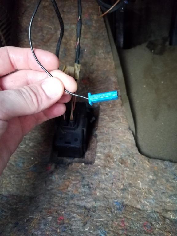

    I have been searching all day for the pronged bulb socket for the instrument cluster. All I can find are the ones that don't have the prongs. Below are pictures of what I'm referring to, as well as a random plug I want to figure out where it goes.

      I think I may have what u are looking for. Let me check my extra parts box...I will let you know.

        Those slide into the cluster and often remain with the harness vs being unplugged.

          The socket is 64111366170
          The bulb is 63217167000
          EDIT:
          The bulb is also known by the Osram part # 33245
