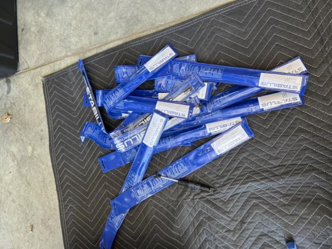

              I bought the struts from Summit, Stabilus 6B-113069 and 6B-128848 for $18 each, which is a lot cheaper than what I found from the usual BMW parts places.
              The difference is night and day, and I also found one of the biggest problems is that the grease for all of the mechanisms had dried up making every adjustment difficult. I wish I could have taken everything apart to clean and properly re-grease, but instead I used some spray lube and penetrant that freed everything up and will hopefully last for a little while.
