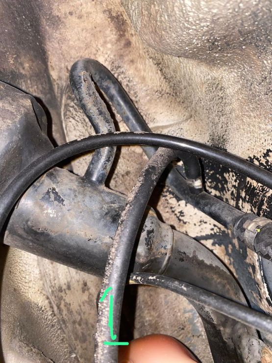

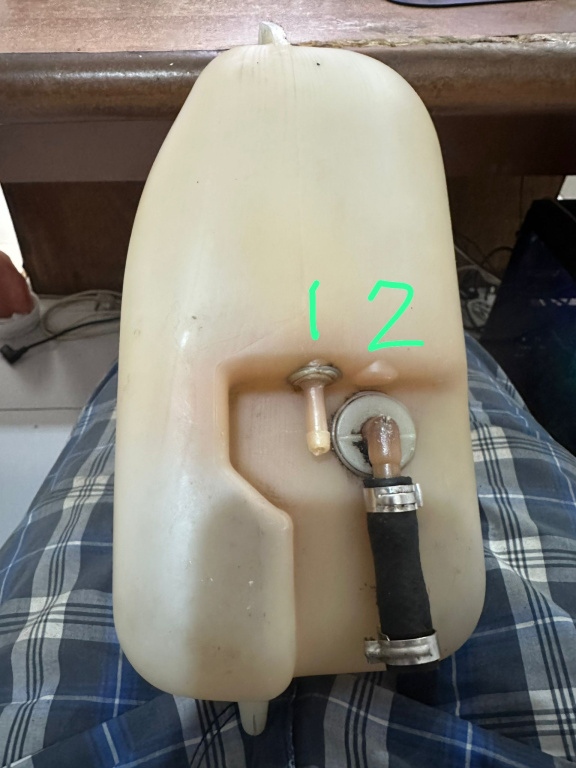

      i opened my evap tank today. And I checked with your diagram. I believe your original diagram is wrong!
      The routing of hoses for (1) in your original diagram is wrong. The rightmost hose on top of the tank should be connected to the thinner tube routed through the tank. And the one on the left side should be connected to BIG fuel hose neck.
      I have a problem of vapor pressure build-up each time i open tank cap. Tremendous pressure escapes from the cap. I took out the evap tank to examine and found that the right side hose is blocked. air cannot escape from inside. Is this the reason why pressure builds up inside?
      Thanks in advance.
          On your car, the hose that is blocked, does it go off to the charcoal canister at the front of the car in the engine bay?
          If so, then yes, blocking this off would not allow the tank to vent properly.

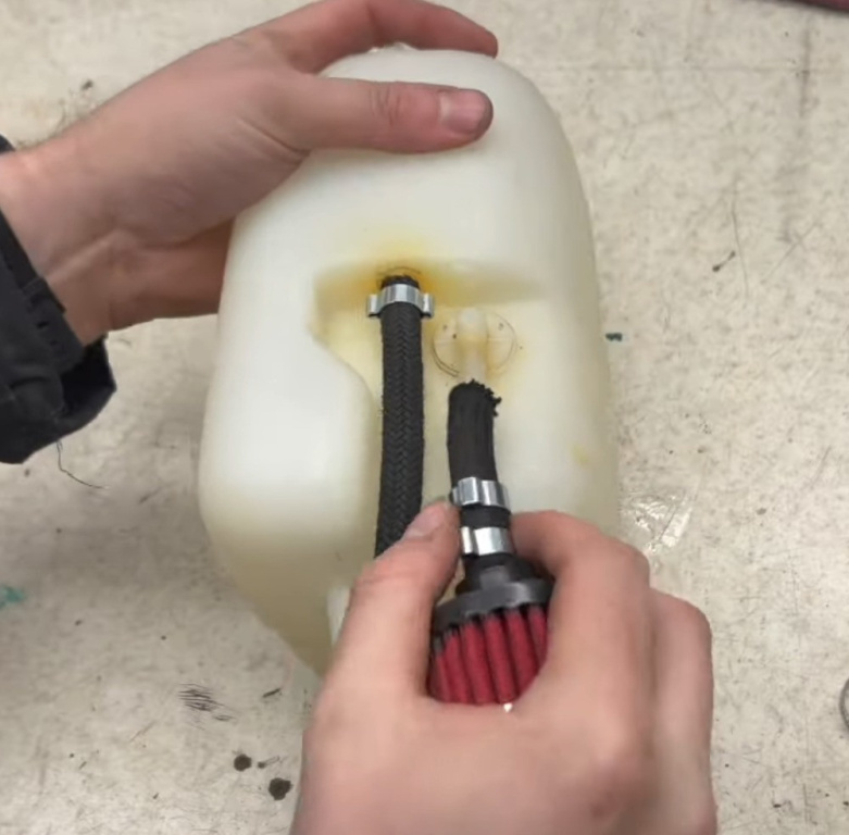

            the line to the engine is NOT blocked deliberately. It must be blocked along the long line all the way to the front. it goes to the charcoal canister in the engine bay.
            So, instead of troubleshooting this line, I decided to do a simple fix by venting it out outside the evap tank using a small motorcycle air filter like this. Costs me one dollar.
              That will work, but I expect you'll smell raw fuel when the fuel tank gets hot and the gas expands.
              Not such a big deal if you park outside, but in a garage it's a dealbreaker for me at least.
