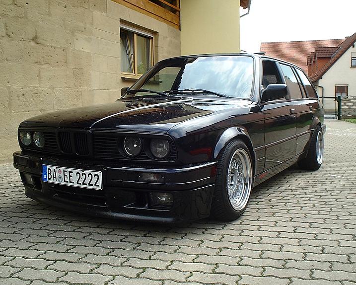

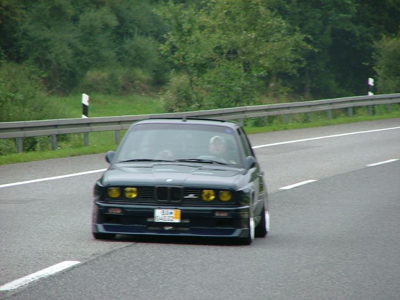

        here are a few pics of the lights i have done. I have done atleast 10 sets to date. not trying to take over your thread, just give some good info to you all.

            Mike's is probably the only DIY job I've seen that looks anything like the real thing. good work!

              thats cause it is the exact same thing as the real thing! I had a set of broken origional black ones, and disected the crap out of em, and with alot of patience, you can do it. order the kit from ebay, or pm me if you cant find it.

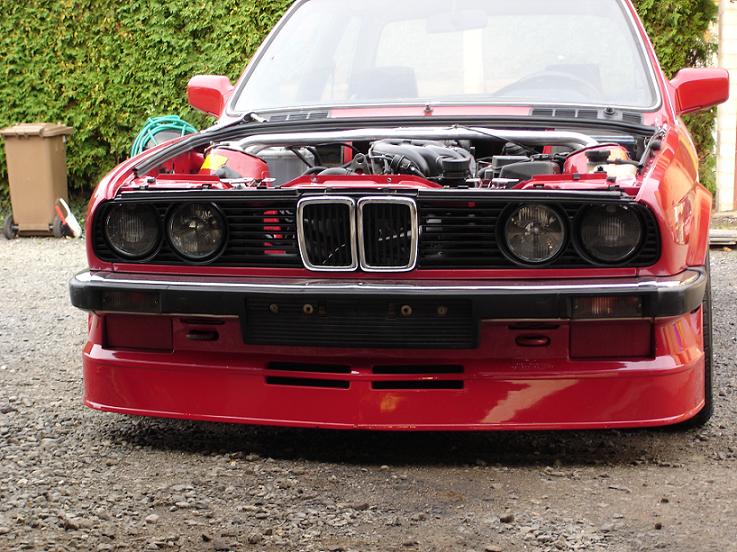

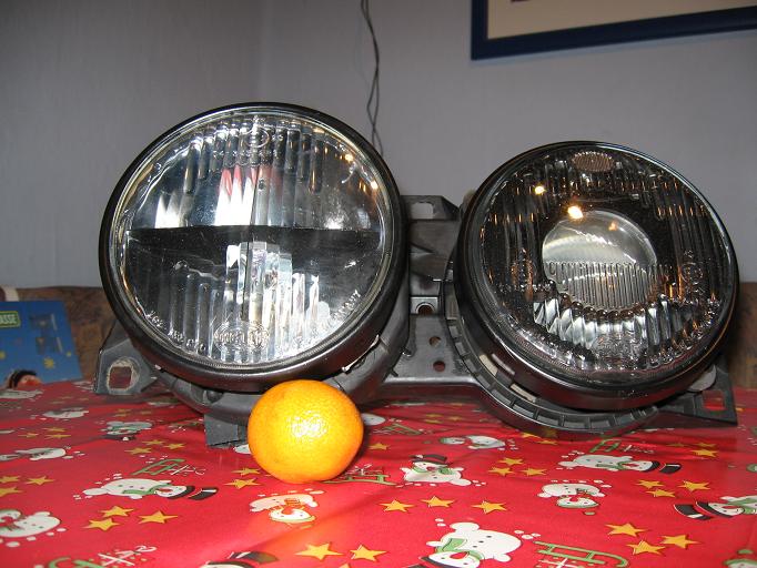

              a couple other pics of sets i did. the tourings went all over the place when the nephew cracked it up! the french set is made from (original) backings, with the french lenses.

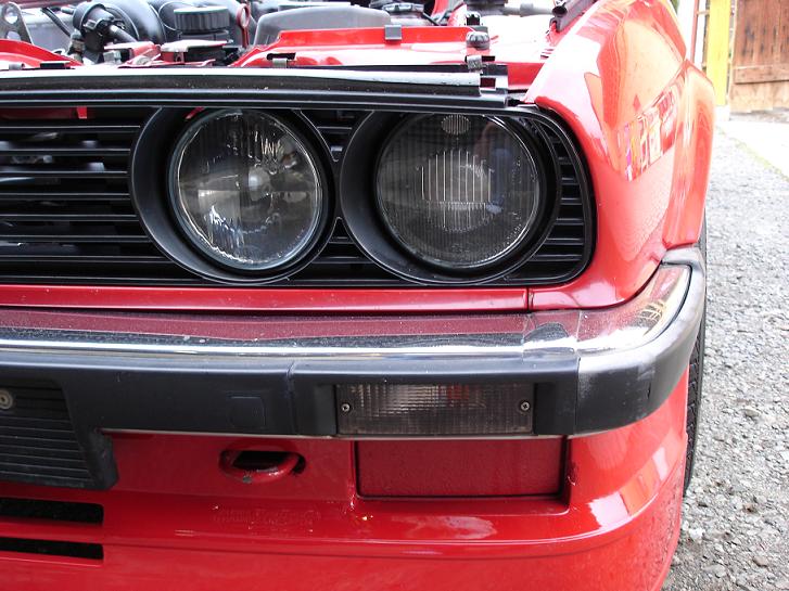

                              Finished mine, just one decent pic...
                              Before: [Acually got these for 20 bucks!]
                              After: [Did break a lense, but i had another one to replace it]

                              • Febi Guibo
                                • Sep 2005
                                • 407
                                SMOKIN!
                                exactly how hard is it to get the lenses off?
                                what did you use to paint the reflectors... did you paint anything else?
                                thanks
