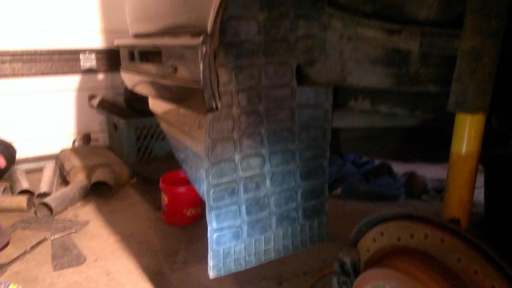

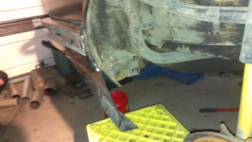

    I was thinking mudflaps at first too, I cut up an old BMW floor mat and was trying to get it positioned but I couldn't figure out a way to make it stay tight against the end of the valance....so now I'm going to make end caps .... if they don't turn out so pretty then at least I'll have something to screw the mud flaps to ;-)

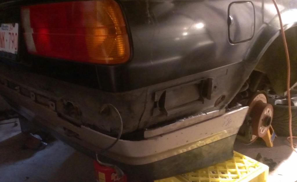

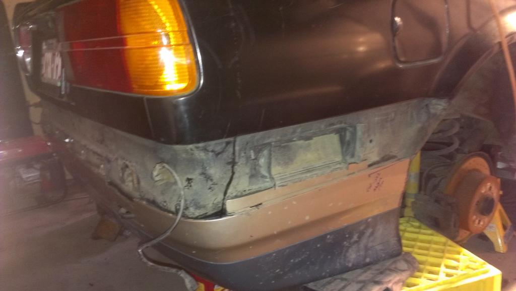

      Some Pictures of progress....made up some end caps and attached them ....more pictures comings soon

          Cut what?my car is an early with plastic bumpers so my bumper sits a little higher now then when it had a diving board . The valance sits about has low as my front lip ,although it kinda hard to tell while my cars all up on jack stands I think it should look good with skirts after its finally done It really required minor cutting... Fits alright ....heres some pictures of a mudflap mock-up I did to hide the gap between valance and fender :-P

            Ah i see, well with the skirts it should all be even. Needs more paint ;)
