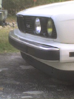

                              can we get some pictures of euro bumpers over the early US valence, aka the dead linked pictures Ryan originally posted?
                                #90
                                here is an 87 db bumper to a 90 convertible shock swap , tucks the bumpers a bit .
