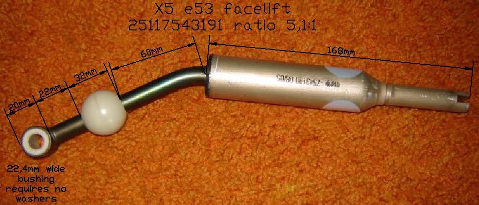

                            • raudonis
                              • Jan 2013
                              • 184
                              #869
                              X5 e53 facelift lever 25117543191
                              X5 e53 facelift lever 25117543191 (requires no washers by the bushing).
                              Photo not mine, just my measurements.
                              My transaction feedback on r3vlimited :):Clickety click
                              • Solarian
                                • Oct 2012
                                • 120
                                #870
                                Does this one require bending to fit?
