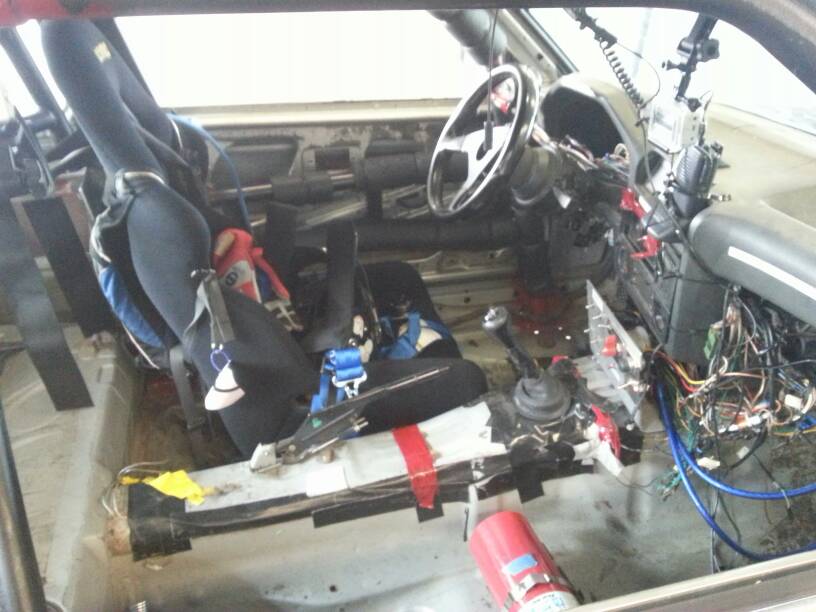

This lever was mentioned in this thread a dozen times.
It needs to be made almost completely straight.
Will need balancer removed from the driveshaft guibo (if there is one).
Will need a longer leather cover for the interior as well.
Different part # for this lever (some are discontinued):
#___________Since___Till
25117540036_2003.09_2005.03_(wide bushing)
25117543190_1999.08_2003.09_(regular bushing)
25117543191_2005.03_2006.09_(wide bushing)
25111434624_1999.08_2003.09_(regular bushing)
25117525645_2003.09_2004.10_(wide bushing)
In my 1983 e30 with sheet steel console 25117543191 lever brought the knob ~2cm higher (compared to stock).
Also did NOT require to cut the existing parts to fit like here: http://www.unofficialbmw.com/e30/dri...new_shift2.jpg
