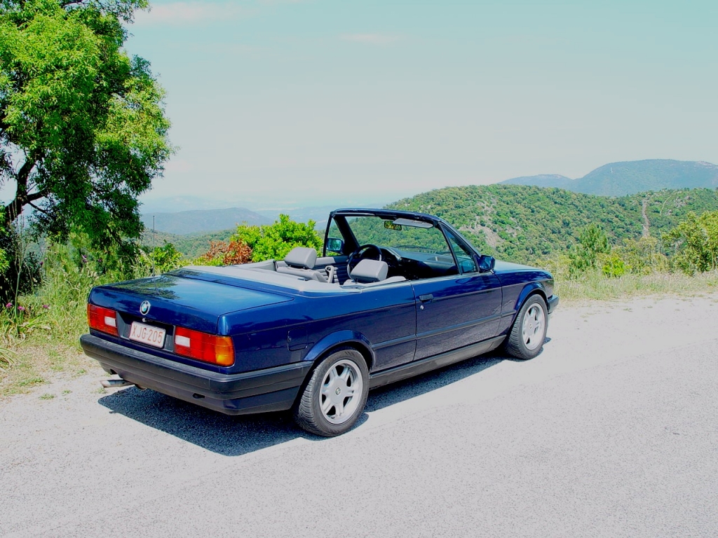

It finally happened, after years of never getting a parking ding, i finally hit something yesterday with my pristine 318ic :-(
