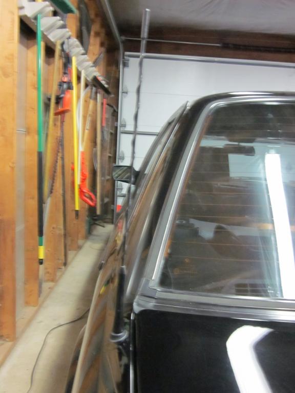

              Finally got around to doing this on my wife's car but when installed, the antenna leans way too far to the left (looking from the rear) rather than straight up. I used the same grommet 65218362369 and installed the same as shown in the pic, so wondering if anyone else had the same issue?

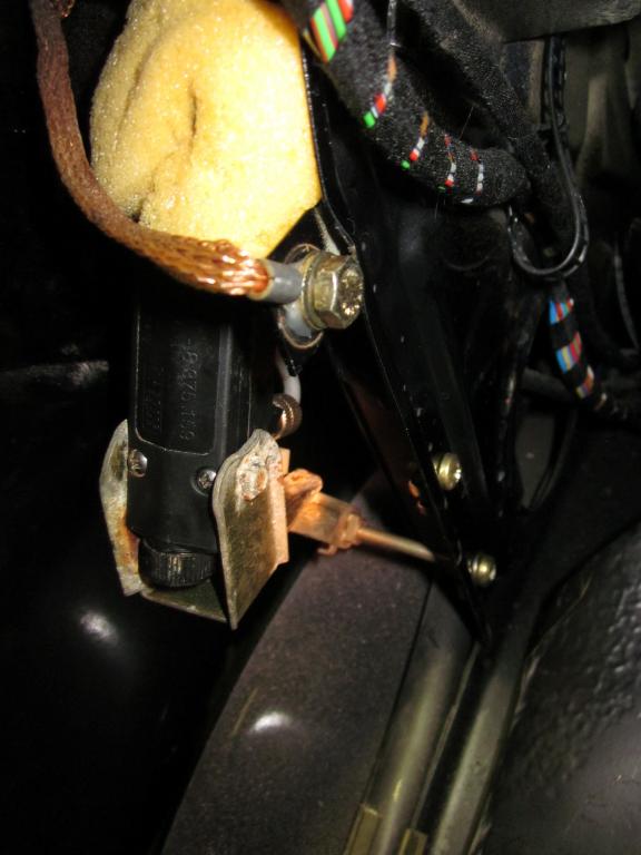

                    I don't know how you guys used zip ties to solve the left lean ugliness cause the base has to be pulled to the left to make it tilt more inward, but anyway here's my easy solution to the problem.
                    You'll need the OEM bracket that secured the antenna base on the 318ti. I'm not sure if the Z3 one is the same, so check real.oem.
                    Remove the lower mounting screw on the amp bracket and then remove the clip nut from behind. Using the OEM bracket, position it like so. The bracket will just push onto the bottom of the base and hold it--don't worry about bolting it on. I also used a piece of foam to wedge in between the base and the body bracket for extra cushioning. Then take the long bolt that originally held the antenna base to the bracket and push it through the hole and screw the nut on part way. Then screw the end of the bolt into the nut on the bracket arm just a few threads to get the antenna angle how you want it. Now tighten the nut down all the way to secure the whole thing. I even adjusted the base in the bracket to give a it just little backward rake too, but that picture wouldn't load for some reason.

                    Should be straight with the world when you're done. This is one of those easy little mods that end up making a big difference. Plus, it's gonna make your car lighter!
