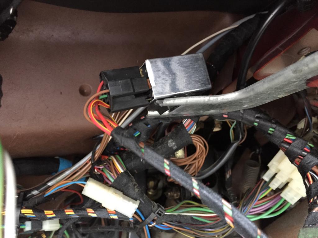

                    I found the rely clamped on top of the bracket holding the ABS.

                        Note, late model (89 on) cars don't have this relay under the dash. Later cars have an integral relay on the ABS hydraulic pump, the integral relay does not have a fusible link.
                        Just done this on my 88iX, I used single core telecom wire to replace the relay internal fusible link and spliced an insulated ATC fuse holder with 7.5amp fuse into the red wire (this is where the relay internal fuse link is connected to), a lot less work than drilling the relay case though this write up was very useful.
                        Total cost - $7.11c from AZ including a bunch of fuses.
