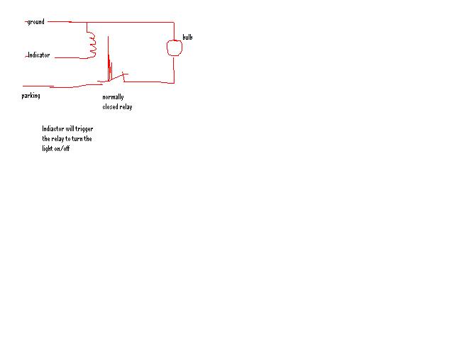

        I was going to run the bulb through a normally closed relay, and the relay would be opening and closing via the indicator wire when you turn them on.
        Excuse the ms.paint drawing..

            Originally posted by Jean
            relays!
            Now that I think about it, my way would inhibit blinking when the parking light is on. I think I had that realization earlier, and was assembling something involving transistors in my head until I got distracted.
            With your method, however, it will not blink at all unless the parking light is on - if the parking wire is grounded and the turn wire starts going and flipping around the relay, nothing will happen, since the bulb's + will see (ground) (disconnected) (ground) (disconnected), the way I'm reading it at least.
            I've got a pencil out right now and am trying to figure this out.
            cars beep boop

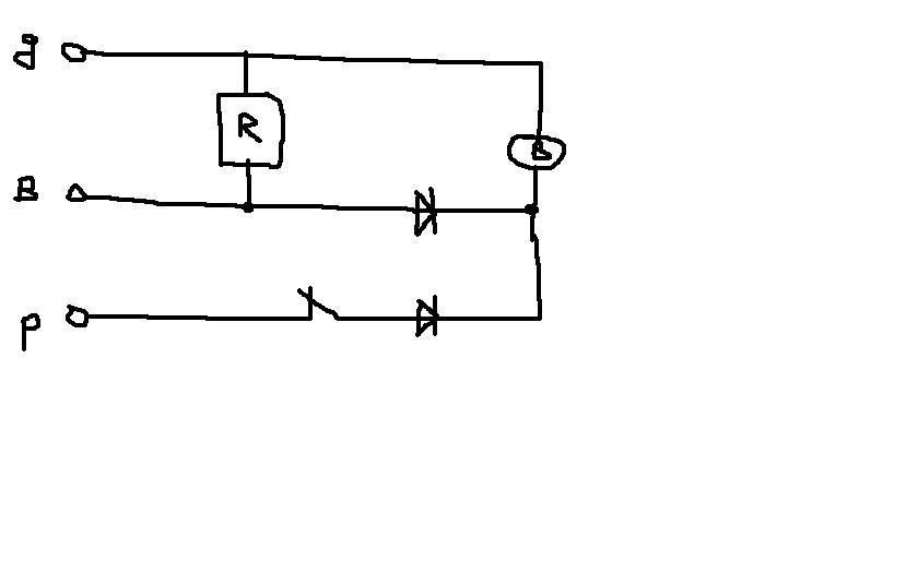

              OK, I figured out a way. What we're trying to do boils down to (blink)XOR(parking). That's doable with a relay if we do it smartly.
              Check out this link, first (it's a java applet thing, you have to wait a bit for it to load)
              I'll be reading up on relays in a bit, but the ones used there look fairly standard. They need a solid source of +, though. You can either run a separate constant + wire or do the thing I did with the diodes to get power when you need it. Diagram:
              I think this will work.

                • Jean
                  • 18228
                  Yep. When parking lights are ON, circuit is complete through the normally closed relay contact.
                  If you blink while parking lights are OFF, bulb is powered directly through the blinker wire, but relay is activated still but that doesn't matter.
                  If you blink while while parking lights are ON, the bulb is powered through the blinker wire and the diodes in the correct orientation will not short circuit the Parking "constant on" and blinker "on/off" wires.

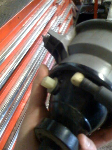

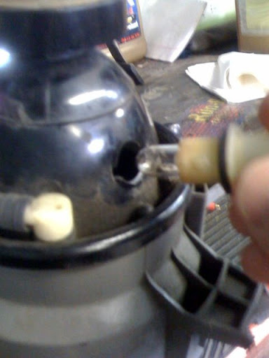

                      Ok here is what I am doing... Not sure if its been done before but today at the shop as I was explaining the dilemma to my mechanic at first he said "thats the way it is..." meaning US has the 3 wires euro has 2 since the parking is in the headlight.
                      So after a bit of pushing here is what we came up with.
                      The 3 wire plug will get split into 2, 2 wires will go to the front signal. This will also feed the repeater which Im going to install on the side fender.
                      The 3rd wire(the parking) along with ground will go into the US elips. Yes US Elips, how you say? Here are some quick pictures as we tested the idea on a broken US Elips(and yes if I havent told you already, please pack all light, ie headlights and tail lights extremely carefully as they will break since most delivery guys love the openning scene of Ace Ventura Pet detective.)
                      Remove the bulb base from the US side bumper parking light. You know the 2 yellows up front and the 2 reds in the back located on the bumper trim...
                      Now drill a hole in the back of the Elips and dremel the 2 square tabs. Just like the turns.
                      Here is what it should look like.
                      The Plastic on the Elips is a bit thinner then the turn housing so you will need an extra gasket so it fits tight and is sealed.
                      When installed it will look like this. It "clicks" in just like the parking light housing.
                      And a quick test on a battery and this is what they will look like, will most likely use a lower voltage bulb.(the top of elips is broken... if you want to know why see my above paragraph)
                      So whatch you think??? I will post pics next week when done. Obviously if you have euro elips, with city lights you can wire those instead of drilling into your headlights...
