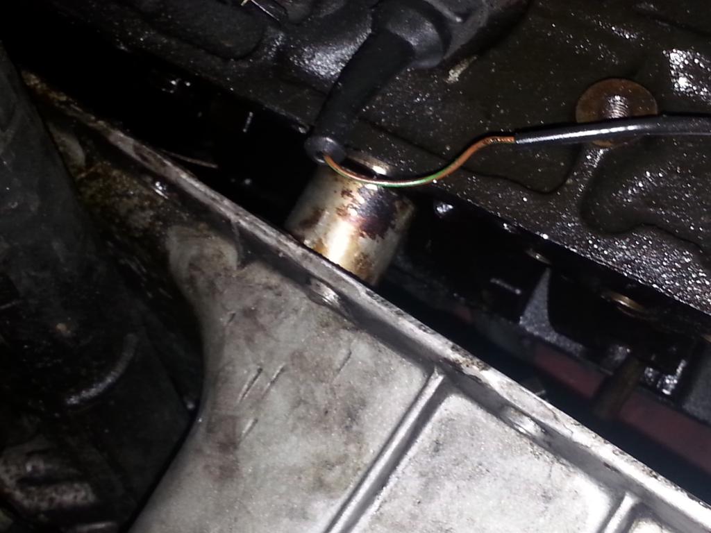

  • raudonis
    replied
    Thank you ingenious people for DREMEL and my wise brain for coming up with golden idea to finally buy it last summer :bow:
    Not so much thank you BMW for using the shit torx screws. The tiny star shapes from 1983 have disintegrated to nothing
    Cut a groove in each head, hammer in handle-less screwdriver, turn with adjustable wrench. No space for the wrench? Grab the screwdriver with a vicegrip, turn the vicegrip using the adjustable wrench
    Then the "surprise little shit" right there by the starter motor, yeah right in the sweet spot The DREMEL extension barely fits, but it does :bow:
    Oil has been drained, to be continued tomorrow...
