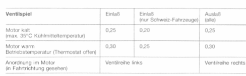

    I was brushing through one of the German manuals i have, and i found this:
    Click image for larger version  Name:	Valve Clearance 1.png Views:	0 Size:	32.2 KB ID:	9895097
    To translate Einlaß means intake, Auslaß is exhaust. It mentions on the second column than the intake valve should be set to 0.20mm when cold "only for swiss models". This has got me thinking, since my 325i is a Swiss model imported by the original owner to Germany back in 1997 (got all documents since then), maybe this is why, there is a slight misfire? it could be a long shot, but if it will cost me €7 for a new gasket and maybe 40 minutes to do, it is worth considering, but wanted to know if anyone here has heard of such a low clearance for the intake valves due to certain model/country cars before (i am also guessing the ECU/DME has been setup for this).

    Possibly something to do with altitude correction or to remedy a specific customer complaint from Switzerland.
    Doubtful that the tune is different to account for a variance in valve lash, but it is possible that it was tuned for lower grade fuel or that Swiss cars were not catalyst equipped.
    • E30SPDFRK
      • 5713
      If anything, tighter valve clearance would be more likely to cause a slight misfire than loose would.
        my 1990 325i does have a factory CAT.
        I was thinking the same, i have both intake and exhaust valves at 0.25mm. Maybe i should get a new cover gasket and check the valve train once over? double check nothing is loose and double check the clearance as well while it is off.

          But to be on topic, you guys recommend sticking with the 0.25mm clearance for both intake and exhaust valves regardless of European, Swiss, USA etc models?
          • roguetoaster
            Biggus Tippus
            • 7830
            Originally posted by S.J.1981
            I shall be re-testing the whole fuel and ignition system once more, as well as another smoke test to be certain that the "basics" are covered before i start removing the valve cover and doing the valve clearance once more.
            Can't think of any reason to go with anything else if the remainder of the valvetrain is healthy.
