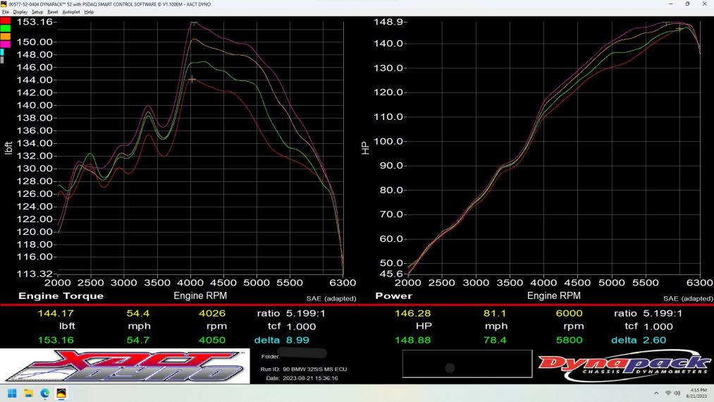

Dyno'd today any suggestions on tuning tweaks?
  • Hoffbrohaus
    • Sep 2013
    • 519
    During the run we dropped the timing advance at high rpms down to 30 and saw some improvement. Here is my dyno chart. I have not seen a torque curve like that before, the up and down from 2500 to 3500. But wondering if it was just the way the guy ran it on the dyno? The HP is smoother though.

    its a lack of smoothing thing, the numbers are small a couple ft-lb here and there nothing to worry about
