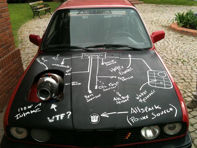

    Zeitronix: I think this is my current candidate for purchase. People loved their zt-2 which enables all sorts of logging and data acquisition. For my purposes, I'll probably just order the zt-3 since it is simpler and MS will monitor most of the other stuff. There's an e30 on their page by Juan in Argentina
    Here's his monster. Is he a r3v member?
Name:	BMW_DiagramedHood (Small).JPG
    Any other brands worth looking at?
