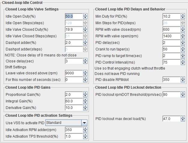

                    So, how fuckd is this? Came with the basemap..

                      I attached closed loop idle settings. I got these from chris325ix tune. Seems like the open and close duty are mixed up.

                        Thanks, guess ill try copying and see if it does the trick :)
                          open should definitely be 50%, closed should be ~20% (where the valve actually closes is hard to define, I bench tested to get these values). the valve actually will continue to open up to 75%, but you'd never want to go above 50%, anyway.
                          if your ICV is wired backwards, then the open/closed duties will also be backwards.
                          also, a 100rpm adder is likely too low, and a 13% TPS activation is way too high.

                            Copyed the copy of chris325ix`s settings and guess what, it works alot better :)
