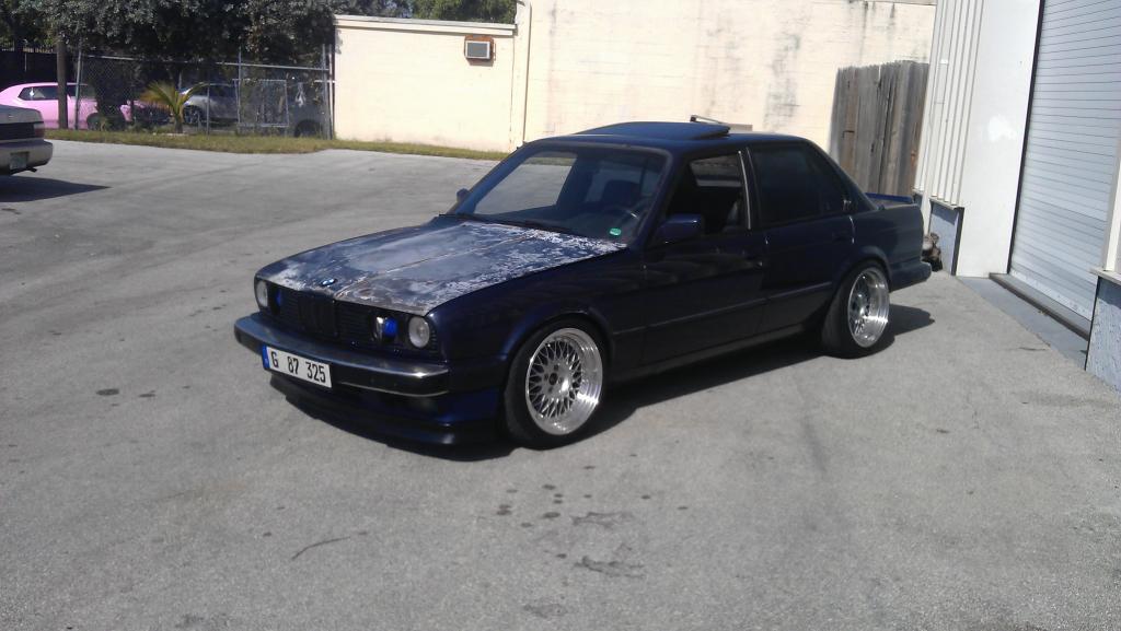

    I need to tune my turbo m20. Im thinking of buying the miller war chip, if you guys have used it I would like to know your feedback on it. Thanks..
