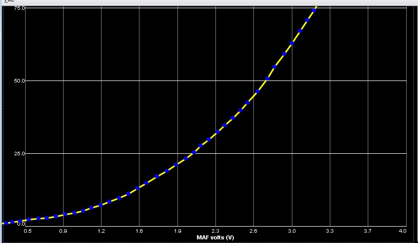

    Mine looks like this right now. I drive around constant throtte and adjust the curve until it get me 14.7 at that point.
    The higher flow part is a little tougher so I'm hoping to follow the OEM curve. Nobody has it?

      Your best bet would be to send it to a company to be flowed. That way they could provide you with the full transfer data. The actual measured flow curve is not as linear as yours. I would contact either Pro-m racing or EFI Systems/Abaco Racing. Both these companies produce aftermarket MAF's and have the equipment to properly flow test your meter. Having the meter actually flowed will make your tuning so much easier, simply copy and paste the data. Once you have that data you won't have to change it again, unless you change injector size.

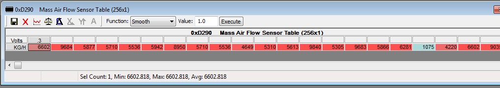

              I found this table, but as I recall I need to do some bit manipulation to get meaningfull data. Does TunerPro do that?
              • ForcedFirebird
                • Feb 2007
                • 8300
                That's not the correct table. You have either a definition or .bin incorrect. There should be a cam retard table and a cam advance table that are about 10x10-ish each or something (don't have TP on this PC ATM).
                john@m20guru.com
                Links:
                • hoveringuy
                  • Dec 2005
                  • 2743
                  Are you thinking fuel? There's fuel advanced/retarded and they're about 10x10, but MAF flow should have nothing to do with the cam position.
