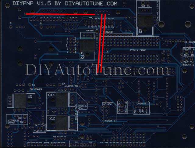

                  okay matt is taking way to long to replay.. whodwho I really need your help here I gotta fix this asap my cars running lean aswell and I was gonna get to tuning but got screwed and need to know what steps to take , so far im getting voltage to the board , I checked some resistors but ill have to redo them and make sure , I get way more voltage when the boot jumper is connected tho to each component this thing is not connecting to anything and is just I think fried or something... if plugged into my car it dose nothing it wont even start the car just the fuel just keeps pumping like always... I tried resoldering a few things and checking them out... is there any way the db9 serial that was installed on the megasquirt has messed up or , and I also feel some components get warm ont he microsquirt so I know im getting power there , I got a serial to serial port aswell as the usb my desktop wont recognize the serial port at all , it shows lt1 which is for a printer and I cant switch it to a com port

                      theee fckkk I just redid my serial db9 port and ... its connecting and giving me some Chinese writing the hell is this is the firmware corrupt and I can reflash it noooo

                          the jummpers out i need a new db9 port ill go buy one tom but one problem u see how there is stainless till rings around the holes i need to repair 2 of them how would i repair them and what is ti called the steel or what ever came off with the db9 port

                            Repaired , matt at DIY repaired my micro squirt I had corrupted the firmware and also damaged the traces which DIY dose not touch any DIYPNP except for the module matt sent me this picture and told me to jumper the DB9 traces were bad here is how it was fixed ,
