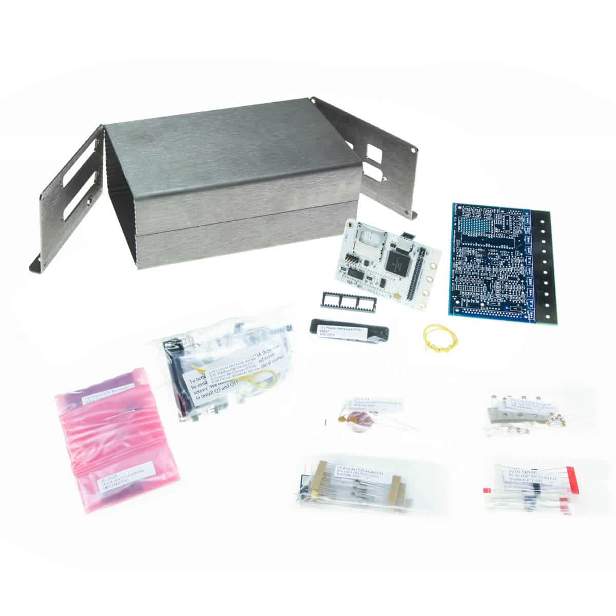

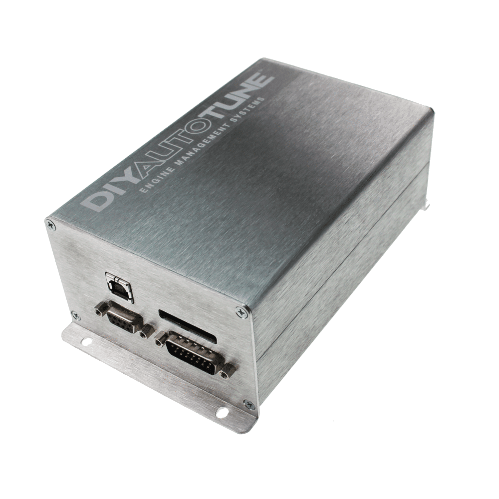

        Thanks Northern. I'll definitely be going after the MS3, since I want to keep with my coils.
        I don't have an IAT that I know of on my M50. I think there may have been one stock, but I don't have one on there right now. (Maybe on the stock airbox, I just have an air filter on there)
        So which of these do I want?
        MS3X arrives equipped with features like sequential fuel & spark, 2 step, progressive nitrous, boost control, onboard traction control & much more!
        MegaSquirt 3 with PCB3.57 – Standalone ECU with USB, CAN, SD logging, and upgrade path to full sequential via MS3X. Ideal for budget tuning with pro-level potential
        MegaSquirt-3 PCB3.0 Kit, assembled your own MS3 ECU with this clearly labeled and packaged kit to make the job easy! Get your MegaSquirt-3 kit here today!

          The top of the 3 is the only one with the ms3x expansion board, which is the way I would go for the ~100 difference, but depending on what you need the others may fit the bill.
