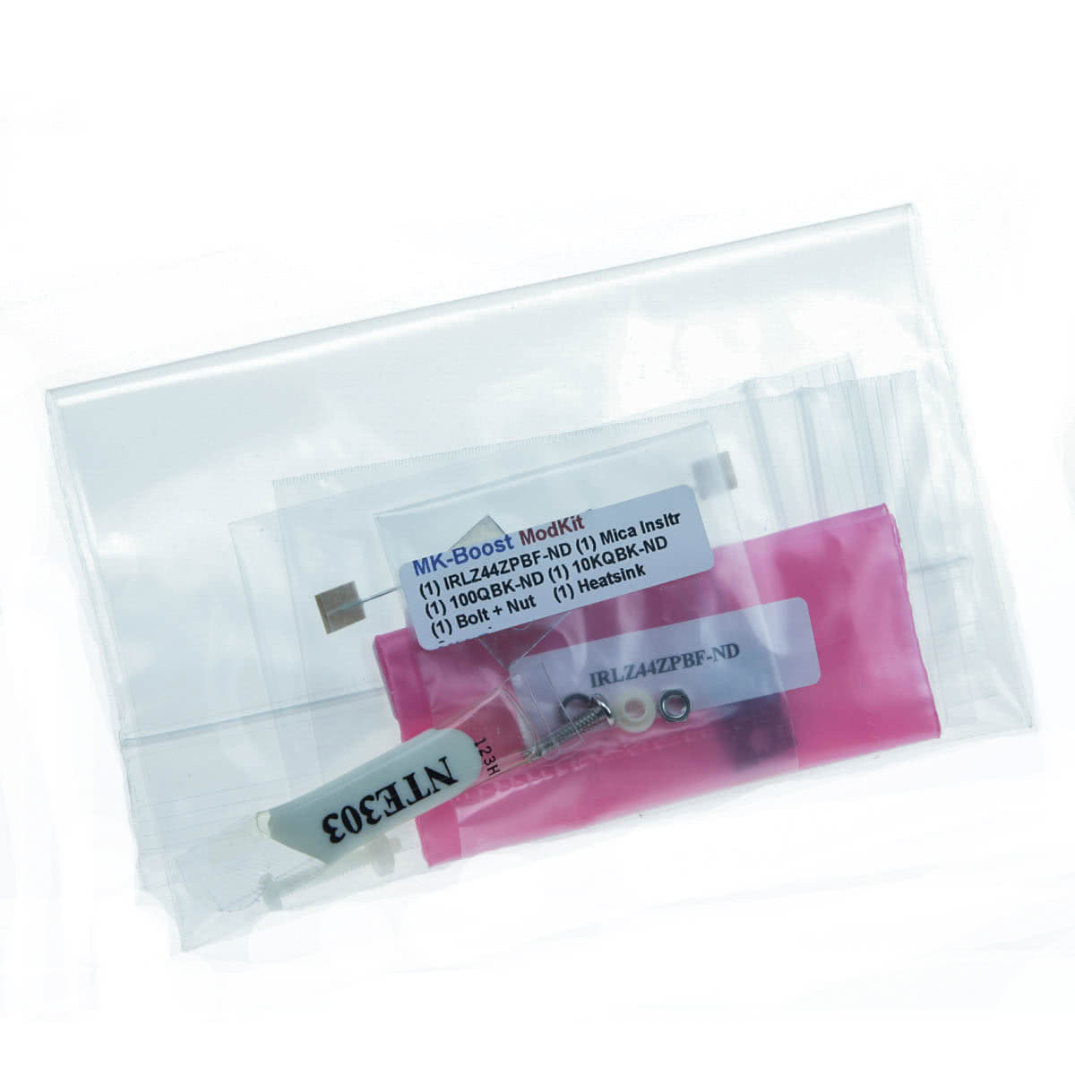

    I believe you need this and the solenoid unless it has the electronic boost controller in it then you just need the solenoid.
    Boost Control Mod Kit for MegaSquirt V2.2, V3.0, or V3.57 PCBs. Add boost control to your MS1/Extra or MS2/Extra build. Reliable FET-based switching.
      https://www.diyautotune.com/product/...ntrol-mod-kit/
      "This mod kit is not required for the MS3-Pro, MSPNP, DIYPNP, MS3X, or MicroSquirt. These units all feature a boost control output as standard equipment; just hook up a solenoid and turn it on in the software."
      Is whodwho's megasquirts based off microsquirt? If so, you only need the solenoid.
      I would email keith if I were you to double check.

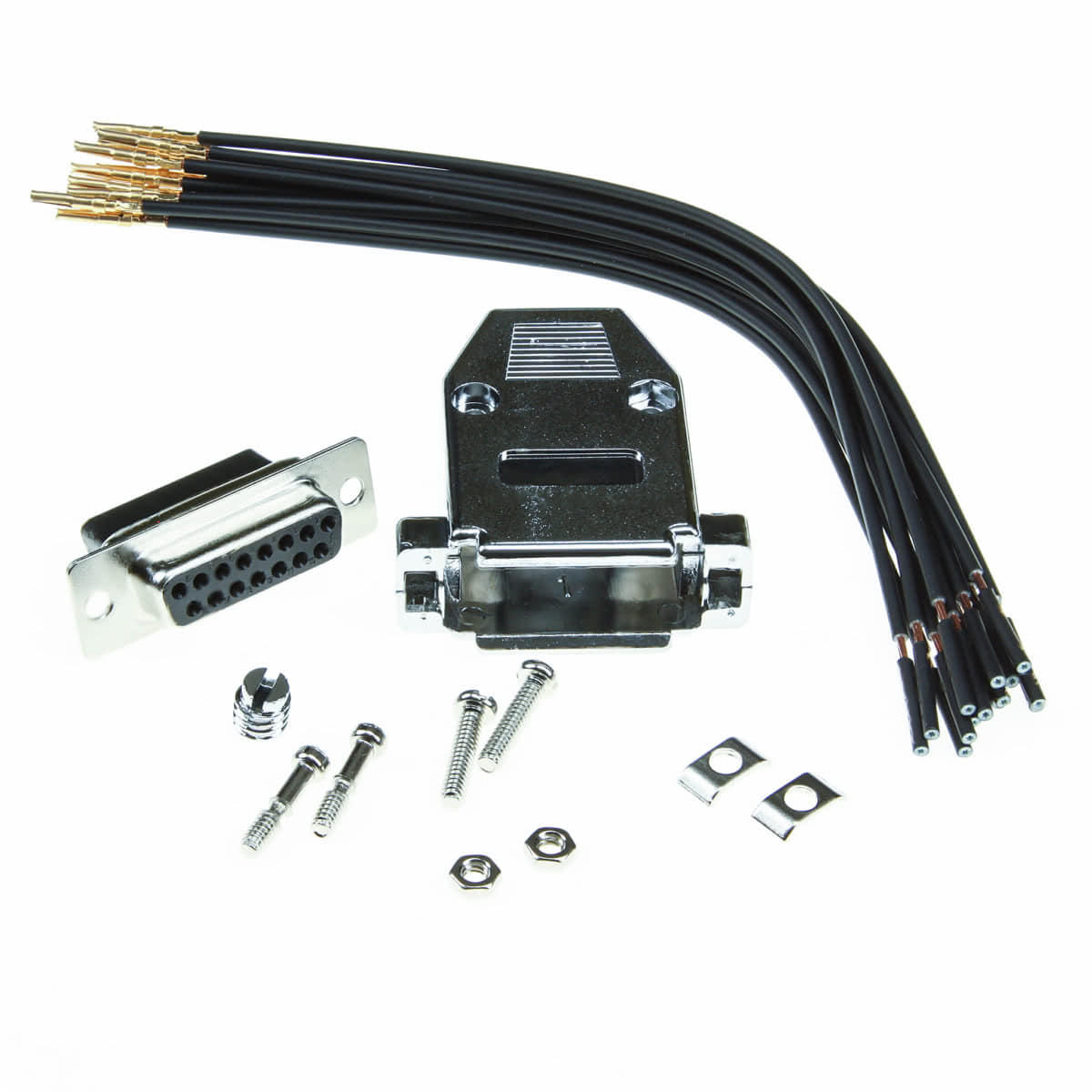

            Awesome! Though I don't seem to remember a DB connector coming with the ECU, I suppose I'll have to buy one? The only thing currently plugged in is the Motronic 55-pin and the boost line for the MAP sensor.
            • ak-
              • 12422
              Yes, you have to buy the connector that I pictured so it plugs into your port pictured below. Obviously the port that isn't for the tuning cable :^)
              I think it's a DB15 connector?
              DB15 pigtail harness for MegaSquirt V3.57 and MSPNP Gen 2 V1.2 (red board). Adds optional outputs via the DB15 expansion port
              There are cheaper options if you google them too I believe.
