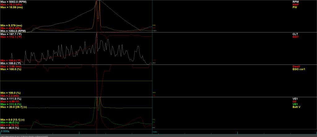

    My car goes all the way through the rpm range fine at a good AFR but when I hit the throttle hard the engine instantly dies. If I let off the throttle the engine will come back to life. I took a log of the issue. My Accel Enrich is 100% MAP based

        please share the MSL, not just an image. In this case, it might help to also share your MSQ.

            Something caused your megasquirt to restart when you nailed the throttle. It comes back on, orients, then attemps to inject fuel again.
            I would try to replicate the issue and log it. It isn't sync loss, so it is probably something to do with the megasquirt ground or 12v power to the ecu.

                Re: megasquirt resets... I would inspect your grounds. If you look at battery voltage in your log, it comes down from 30 volts after the restart. If you want, grab some jumper cables and ground the motor to the chassis and see if helps.
