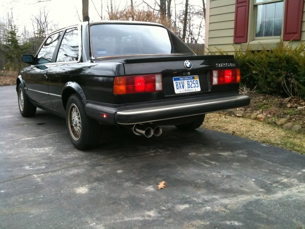

              update. i ended up ordering the 14816. since making this thread i have decided just to put the muffler on. the header is gonna collect dust in the attic, and everything is staying stock except for the muffler. i've been driving around now with 2 holes in my exhaust, and loud noise is making me crazy.

                  i should have gotten the 14815 because the one i got is a bit bigger than i thought it would be. when it said 2.25" in, and 3.5" out, i thought the 3.5" included both tips for some reason. lol, ooops.
                  once it's low i think it will be less noticeable. or if i can find a valence somewhere that doesn't look like crap. i like the way it sounds though.

                    Dane, thanks so much for posting that pic.
                    I think it could be better with a valence or lowering the car or whatever.
                    I think that would kick ass on my E34!

                          ^do you have any pictures looking down the exhaust tips at muffler level? I like this muffler but it looks like the inside of the tips are slanted
