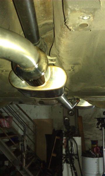

      Don't try to fit an oval muffler in center section. I made a mistake by using an oval shape muffler (magnaflow 11366) as resonator. It was a little too thick.
      Installer had to cut away a portion of heat shield to fit and avoiding hanging the box too low. This will heat up CSB and kill it fast.
Name:	IMAG0216 (Medium).jpg

        an oval muffler will fit fine if you mount it further back, just in front of the subframe.

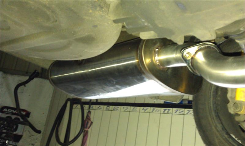

                    Similar size to this? It's a 22 inch 5x11" Mangaflow
Name:	IMAG0217 (Medium).jpg

                      I looked at it yesterday. It's way bigger than a stock m42 muffler
