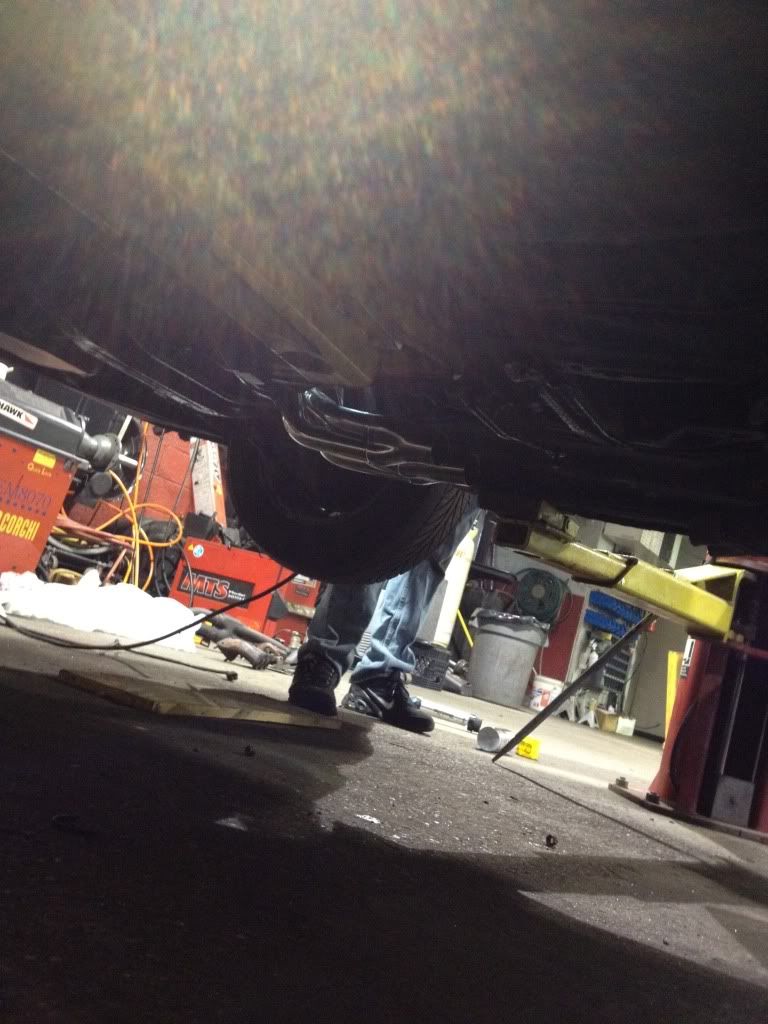

                          #42
                          LOL ^^^ hes 100% right. i drove it open header to an exhaust shop 5 minutes away. it sucked after the first minute of driving lol.
                          i received the car back today, the headers were about 5 inches away from the floor after they fitted my pipes. im not even exaggerating. my car is seriously dumped, so im going to bring up the coils a little and cut my perches while im at it. ill post pictures when everything is done correctly tomorrow. i just moved the car from front of the shop to back, but startup sounded AWESOME!
