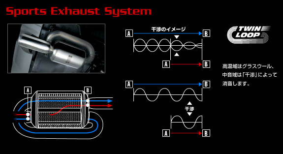

    Idea 1: 3" downpipe to cutout, resonator, 2.5" Borla dual in/out and loop it through like a Mugen twin loop with a turndown (will be cutting the tire well as to mount the muffler sideways for space)

    Idea 2: 3" downpipe to cutout, magnaflow 3" in/dual 2.5 out to the same borla and just straight through to turndowns.
    Any thoughts and feedback would be greatly appreciated.

            That twin loop thing looks like it's going to be loud and a butt plug
              they are loud. at least on NA cars. Go with a straight regular style muffler. youll be much happy you did. trust me.

                But i will forever live in regret not knowing how it would've sounded haha. Seriously though, I will take your advice. 3" to Muffler. simple enough.
