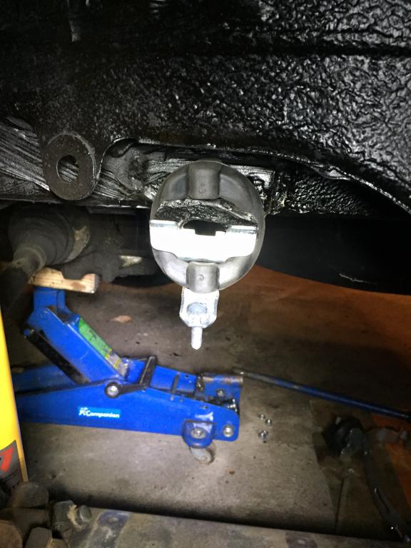

    Any tips/tricks for installing new rubber donuts and hangers? Also which way is the donut suppose to be sitting like pictured or rotated 90*?
  • McGyver
    • 4636
    So first, It's supposed to be rotated 90* so that the lumps are between the two metal parts.
    Second, (for stock exhaust clamps) I remove the metal heat shield over the muffler. Then separate the hangers into their 2 parts. I put the donut on the car side, then use a big screw driver to help force the donut onto the hanger side. This allows you to pry against the car. Once both are on, I replace the shield, then use a jack to lift the muffler into place and put the hangers back together.
    On non-stock exhaust, I usually put the donut on the muffler hanger, use a jack to hold the muffler in place, then use a big screw driver and a lot of 4-letter words to get the donut on the car.
    Good luck!

      Got them on, and the exhaust hung. Bit of a pain to get the donuts on, but it worked out.
