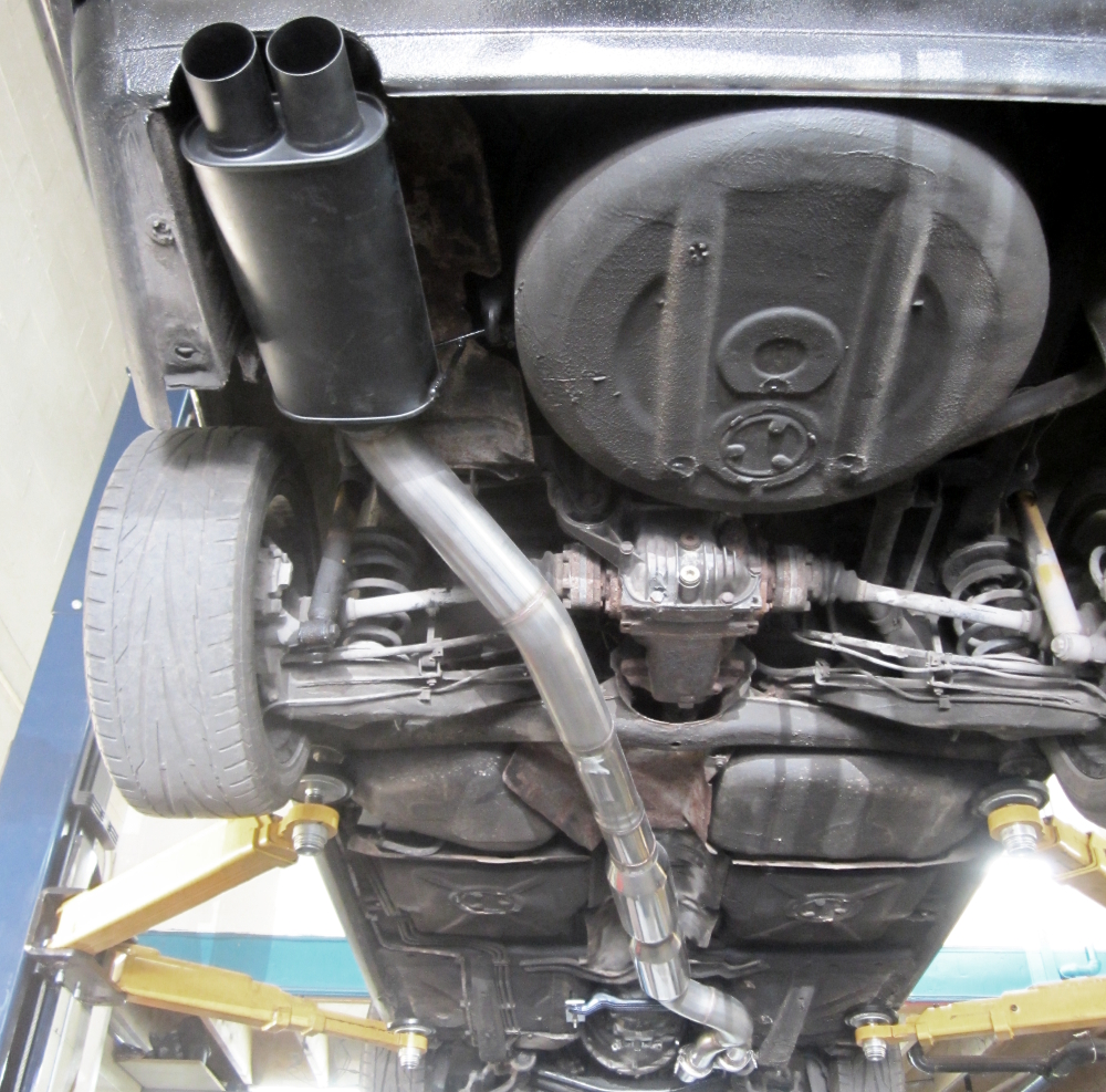

        Personally, I think the one pipe design looks cleaner. And a one pipe design even gets done on swaps, like this S54 swap done up here in Canada (sadly, the guy who built this system doesn't do it anymore.)
