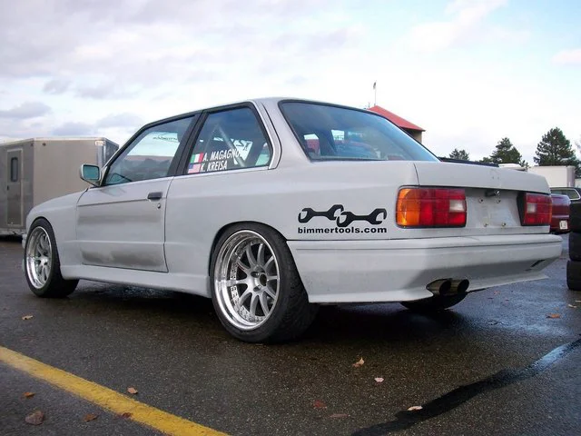

    Originally posted by yberther
    ^truth, also car looks FAST.
    it was squatting the whole straight :) :)
    Thank you. Take a look at the pics of the car sitting still... then pause the video after it is in front of the GT3... a good portion of the RIM is tucking under the fender! That is under power after the shift into 4th gear.

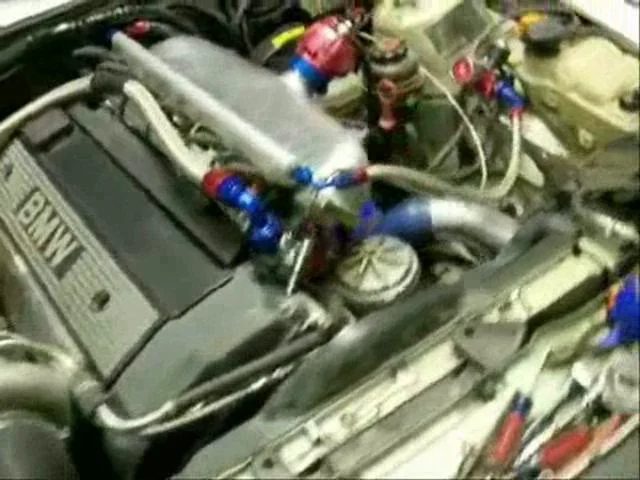

    Originally posted by Under_Pressure
    You know u lost a good amount of flow with that downpipe setup. Having a larger area in the exhaust causes bad flow patterns that kills power. May I ask why you reduced the DP's exit back to orriginal size?
    Really... Hmmm how can you quantify that when most of the exhaust velocity happens in the first few feet? It helps turbo spool and overall flow through expansion. However, you don't have to believe me. Someday I will possibly have a 4" exhaust... so at least I am already prepped for it. And lastly I have 4" dp because I can. The Best exhaust on a turbo is basically NO exhaust. So the biggest you can fit the better. Different case on a NA car altogether. Ever ask yourself why upgrade 3" dp on VW 1.8t's even with stock exhaust run stronger? That potentially disproves your theory. But you are entitled to your opinions and theories as am I. this is probably my 15th custom built turbo system. But thanks for your input I appreciate it :)

  • Under_Pressure
    replied

    Originally posted by Good & Tight
    Great fab skills, I have been watching your build thread on bf. You should try wrapping the down pipe so it wont cook the valve cover. My setup is similar, down pipe not as close and wrapped though. is it a 4" or 3" dp?
    Thanks!
    It's 4"... and I'd like to wrap it... probably will this winter. The melting came from when I drove it before I calibrated the timing... I was 21* retard from 0! So, all of my map timing numbers were -21*. The EGT's were out of control! I could tell that without an EGT gauge. Since then it seems as though the valve cover hasn't gotten any worse.

  • Good & Tight
    replied
