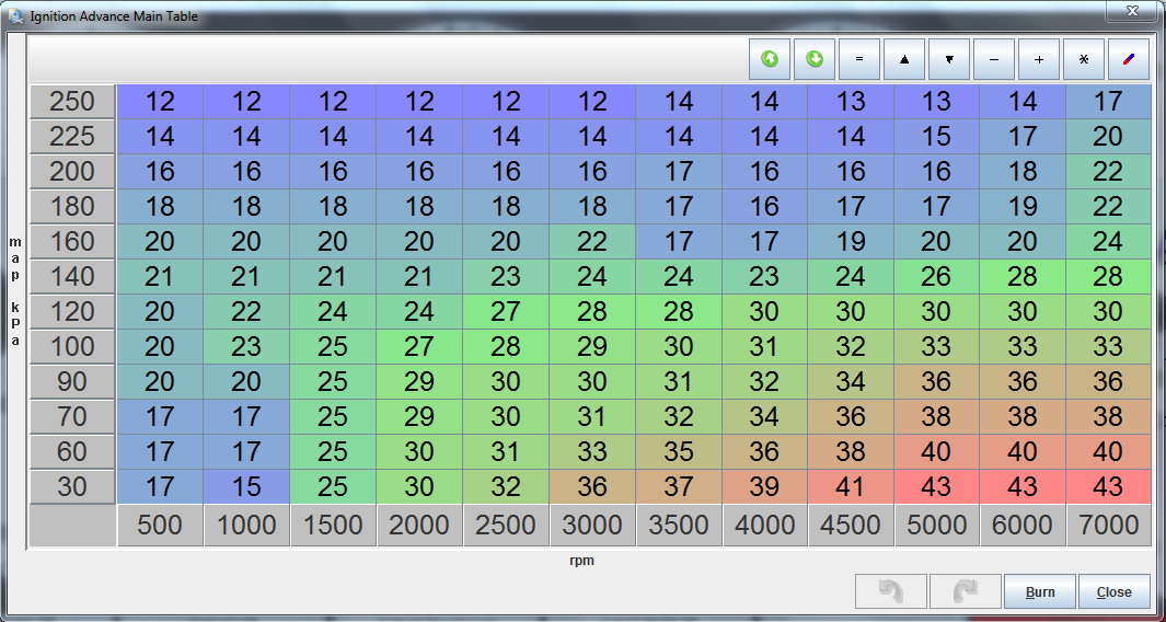

    California 91 pump gas is not exactly a fan of advanced timing. lol. Most of the guys in LA also run "small" turbos compared to you guys.
    Here is a map done at Church Automotive which is a well known and respected dyno tuner.

      Our tables aren't that far apart. Pretty close if you ask me.

        Does it still make power at 250kpa and only 13*?
          The car does not boost that high. I believe that's just for protection in case the wastegate malfunctions. But the 25% increase in timing that you guys can run at 200kpa would cost me a new engine. 10% increase popped the head gasket. Its a fine line between pinging and not making any power. Currently working on a super eta block, bigger intercooler, and a larger exhaust. I'd like to be in the 450-500 range.
