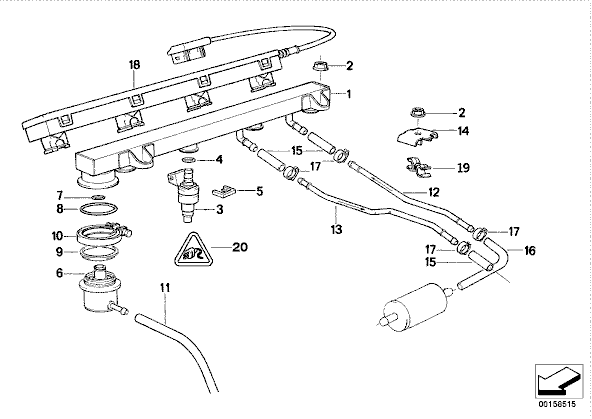

                      My injectors keep popping off!!! Why is it doing this? is it because they are mustang injectors?
                      The Current Army
                      -(UnderConstruction) 1991 330iS 24v S52 build thread
                      -1992 325iC
                      -1987 E30 Truck
                      -1991 332iS (BecauseRacecar)
                      -1988 Dinan M3
                      -1988 325iX Tribute car
                      -1989 320i Touring (S52/6spd)
                      • MonkeyMadness
                        • 3251
                        is your fuel rail bolted down?
                        Are you missing #2 bolts?????

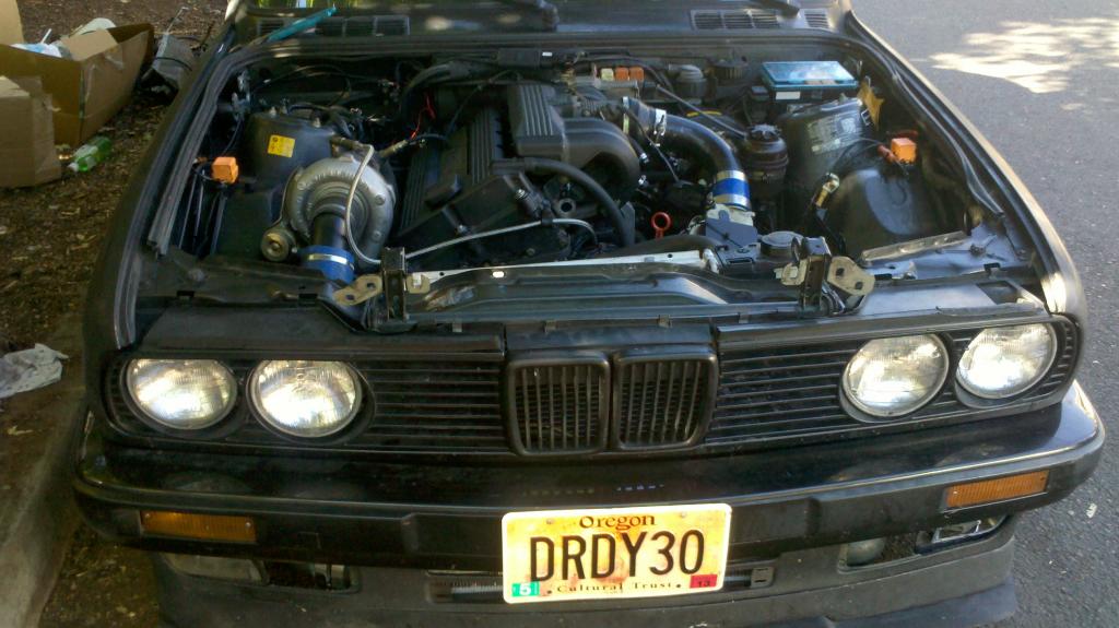

                              • aus-m42turbo
                                • Aug 2011
                                • 9
                                I have opted to go stand alone (Haltech) becuase I did not believe the war chip was available for our model motronic ending 175. I asked this question less than 2 months ago and have since bought the haltech. Can you confirm for me that you have sucessfuly installed and running a tune able war chip.
                                Engine bay looks great and despite the hugh snail it still looks close to standard. good work
