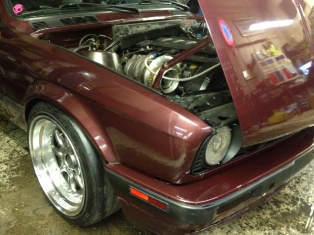

                      #40
                      Turbo back from powder coating, I had it rebuilt but it still seems to be leaking so I have to try again, also while thats being done i think ill pull the intake manifold off check all my vacuum routing and lines, fix the small coolant leak i have coming from the temp sensor in the head, and have the valve cover wrinkle blacked. along with the IC
                      bummed about the turbo i pulled the car out just to drive her around the lot for some motivation, heres a screenshot from the video i tried to take, camera fell which is why its angled so hood.

                                #45
                                what manifold is that exactly?
