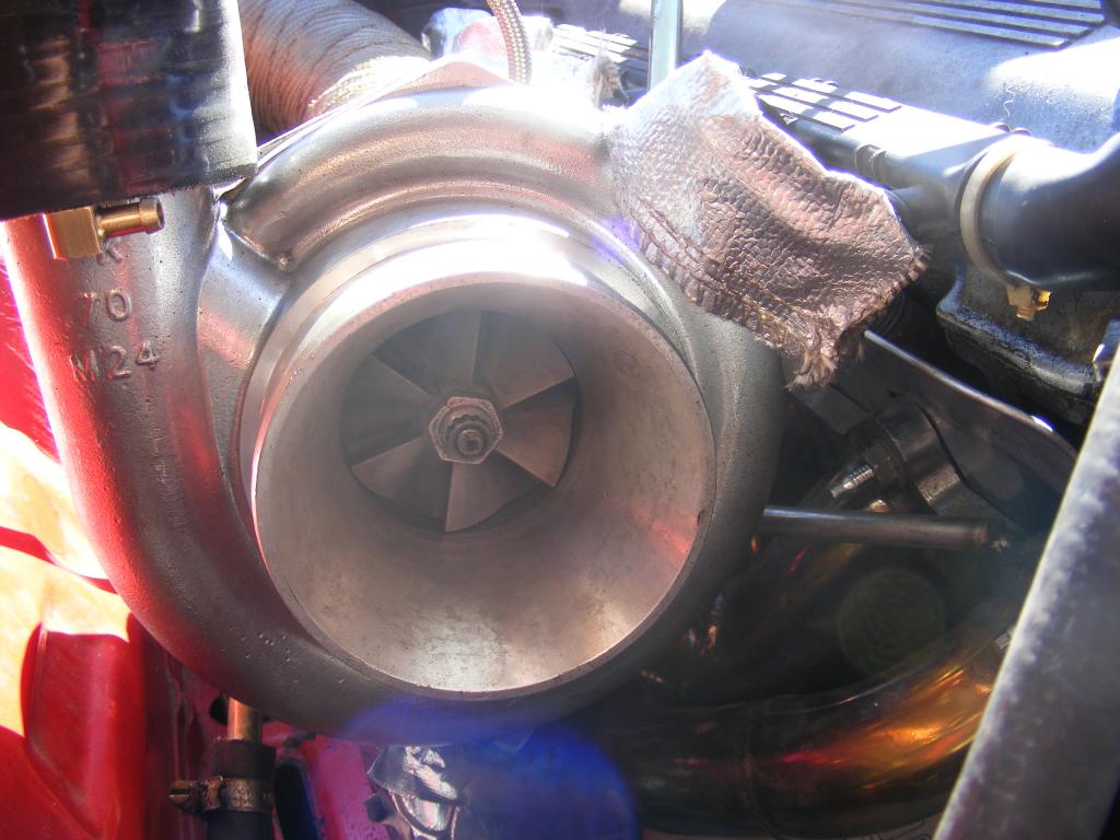

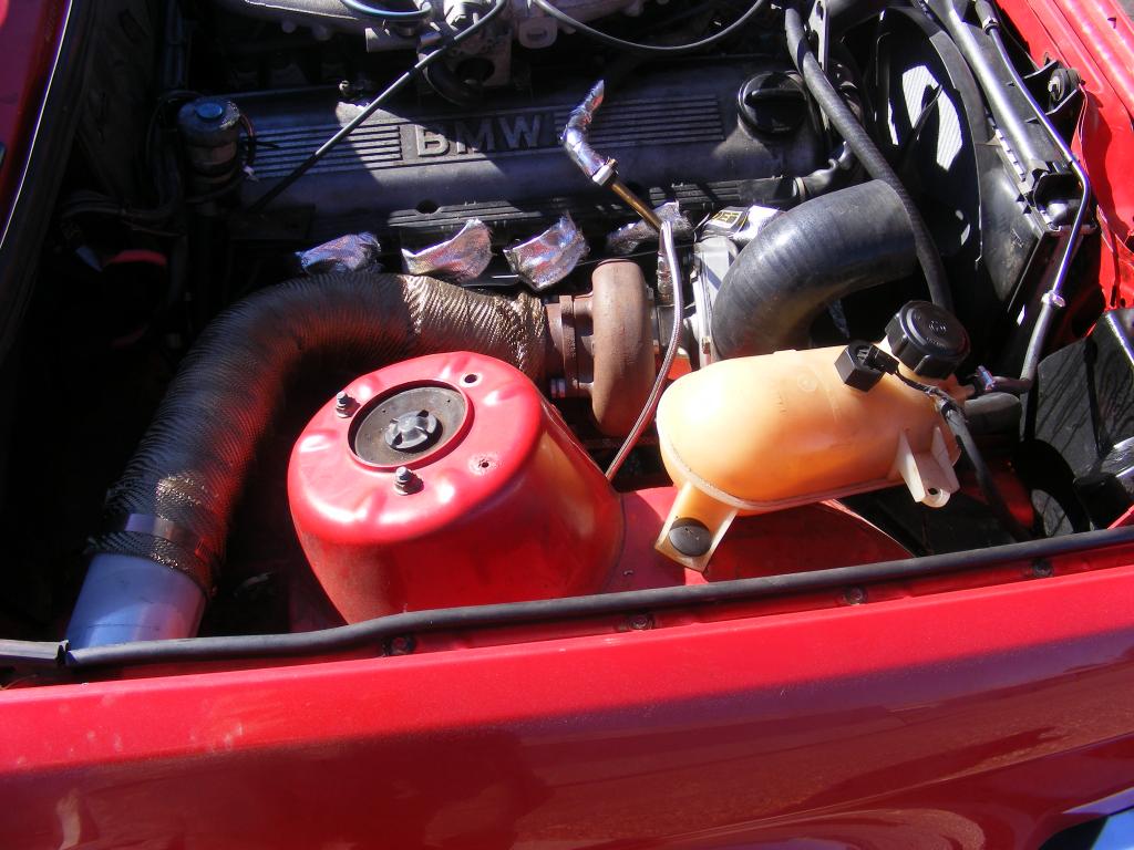

                    got the turbo on Im curently waiting for the fmic kit, wg and ecu to arrive. i have to do a side exhaust out the finder. fml its loud. ill post pics soon!
                      Here are some pics of the turbo on the car. I still need to clean up the finder with some carbon fiber (more pics coming) and make the bracket for the coolent resovior.
                        Is that dumped out the fender?

                          yeah. I couldnt go anywhere with the downpipe, with the steering rack in the way. so keep it na- not going to happen, go out the hood- gay or out the finder also gay. are you going to be out friday?
