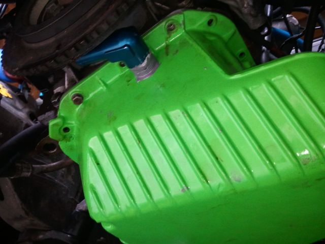

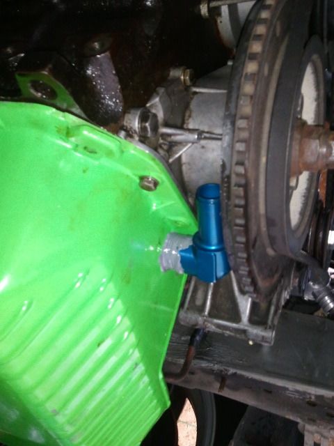

      You need to take your pan off to do it anyway you do it.
      This is best
      Tapped 3/4in (doesnt have to be that big) threaded and sealed with jb weld. Its a lot easier than welding that shitty cast aluminum. And its the highest point on the pan. Ive ran that pan set up while sliding sideways and being crazy and never had drain issues
      I also have that pan in the pic if you want to buy a pre tapped one :)

            Only welding it would have been nice but that is the highest point on the pan

              Meh welding it would be nice but jbweld works fine. No leaks at all

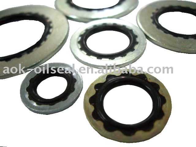

                  Dudes, use a bulkhead fitting and two bonded rubber sealing washers

                      some of these
