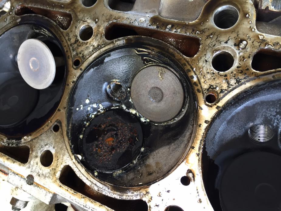

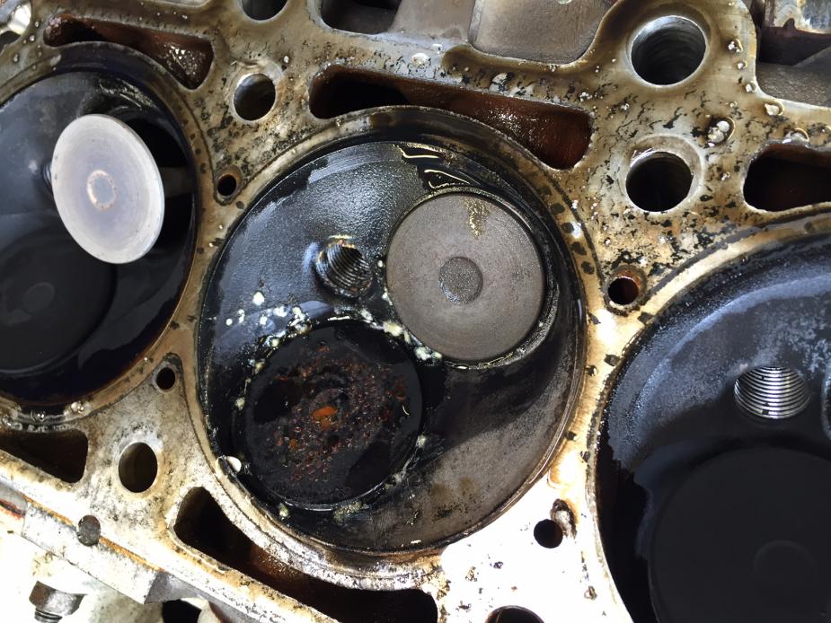

    So on the way to the E30 Picnic my turbo m20 decided to give in, but it doesn't make sense why it happened, and tuners and mechanics agree too. So please turbo experts, enlighten me
    Engine is a 2.7i: Super eta block, with 2.5 885 head. Block is oringed, thicker headgasket for lower compression, ARP head studs (one stud is broken now), 284 degree camshaft, Ireland Engineering HD rocker arm set, plus the motor was rebuilt, car was tuned well by a reputable tuner locally on the dyno, car didn't seem to be overheating (I think) and lastly it was at only running at 11PSI of boost, and I was just cruising when the Head gasket popped on me.
    Why could this have happened, and will it be worth doing rods and pistons now that the engine is disassembled?
    Edit: I don't know how to post multiple pictures lol

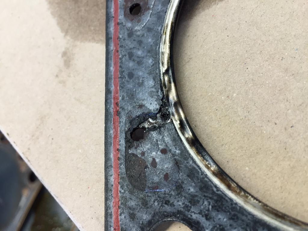

    She detonated man, almost certainly. That fire ring is mashed! Was it just the one cylinder? What fuel? What turbo?
    It might be worth getting your injectors flow tested to check for issues.
      They are nearly brand new Siemens Deka 80 LBers, the tune is set up on 94 Canadian, which is equivalent to American 91, as tuners have told me, so at the time I was on Shell 92 American (Better than what tune is set up for), and the turbo is a GT35R, also the main cylinder that felt it was #2. But if it really is detonation, is that just from poor fuelling?

            what do the piston crowns look like? what do the plugs look like (what heat range) and what do the combustion chambers look like? any signs of detonation or just being too hot?
            what head bolting strategy and how many miles on it? did you check tension after a few heat cycles? why is a stud broken?

                    Figured out how to post more pics:
                    • digger
                      • Nov 2005
                      • 6192

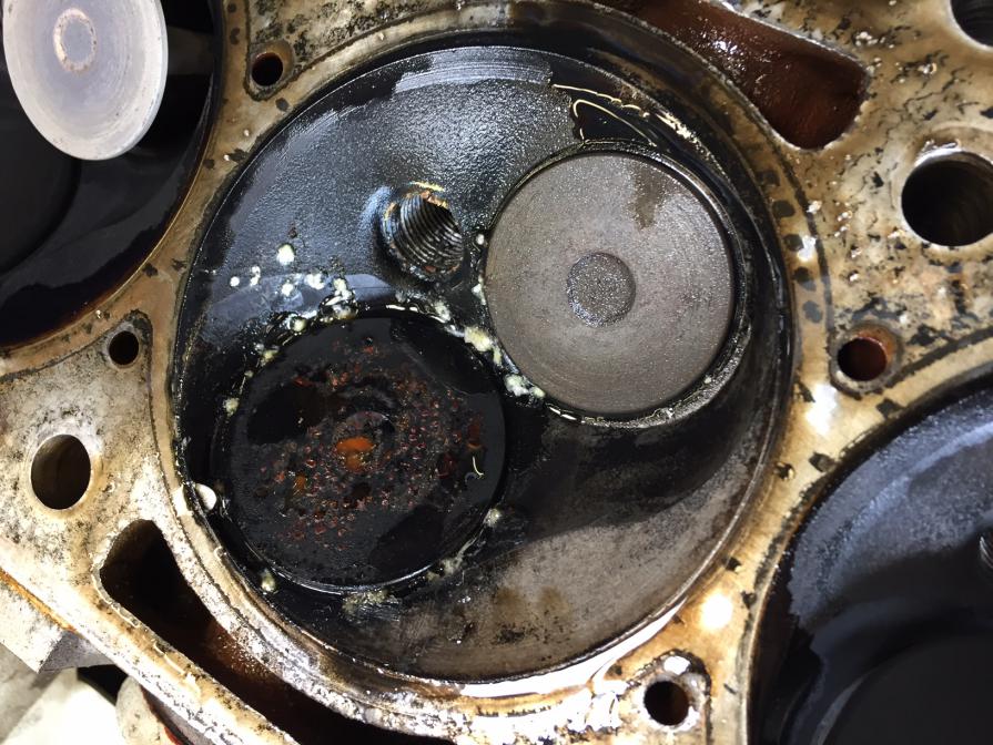

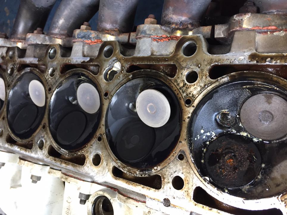

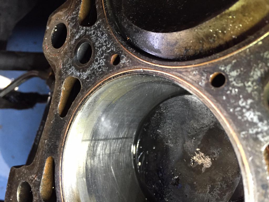

                      doesn't appear to be immediate signs of detonation. the one chamber looks a little cleaner as far as carbon goes but could be because the coolant clean it off. the exhaust valve is a different color?
                      what coolant do you use?
                      id invest in an OEM headgasket to.
