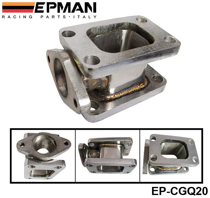

        Also, you could use this manifold with this adapter for the turbo. Its what I have that didn't fit the ix motor mount. Should work fine for what you want if you are set on an external wastegate. I would add a support bar to help prevent it from cracking.
        http://www.ebay.com/itm/T3-Flange-St...LwhX2w&vxp=mtr
        http://www.dhgate.com/product/epman-...HGSRoCDRXw_wcB
