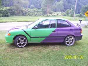

                    I also own a 1995 Hyundai Accent, that is slightly modified. But it is not my choice car to drive. I love my BMW and it is my choice car to drive!
Name:	Hyundai Rice 2.jpg
ID:	7108071Click image for larger version

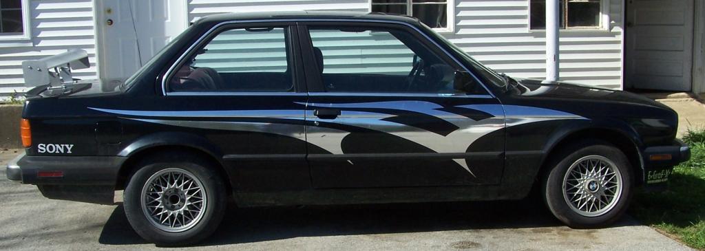

                      ^^^ That THING is your BMW?

                        did you do that to it?

                          Yes, I Did!

                          Yes, I Did! I thought it would be interesting, it is only vinyl! It is easy to remove with no damage to the finish. The wing is actually functional, it provides a good bit of down force over eighty miles an hour.
                          It also gets all the little foreign car owners going, I have outrun every ricer in my area for miles! I have raced and out run both Chevy and Ford pick up trucks too! The negative side is the attention it gets from the police,also lights reflect of that chrome very well!
                          The only vehicle to yet give me trouble was a PT Cruiser GT Turbo, he was hard to beat. He got off the line really fast, but I got the RPMs up and passed him, but for a few seconds I wasn't sure!
