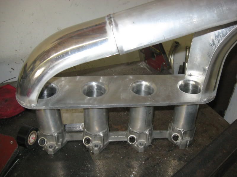

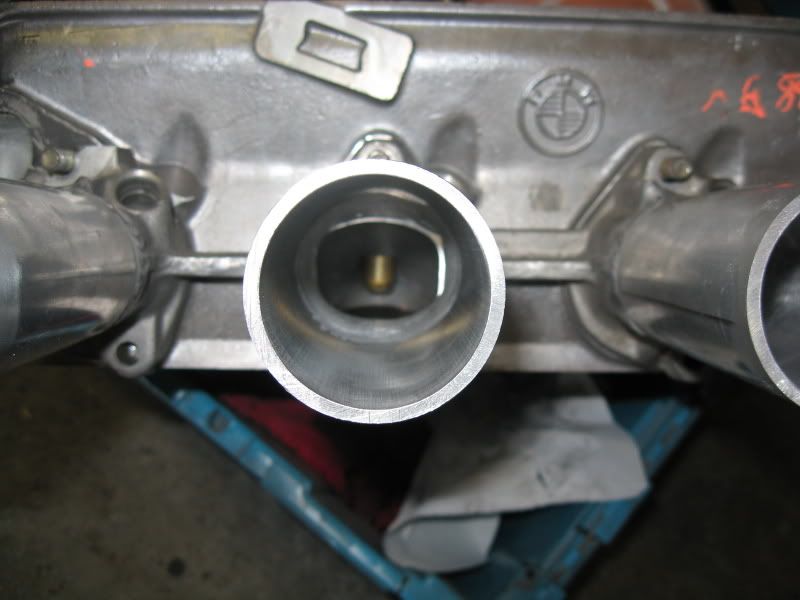

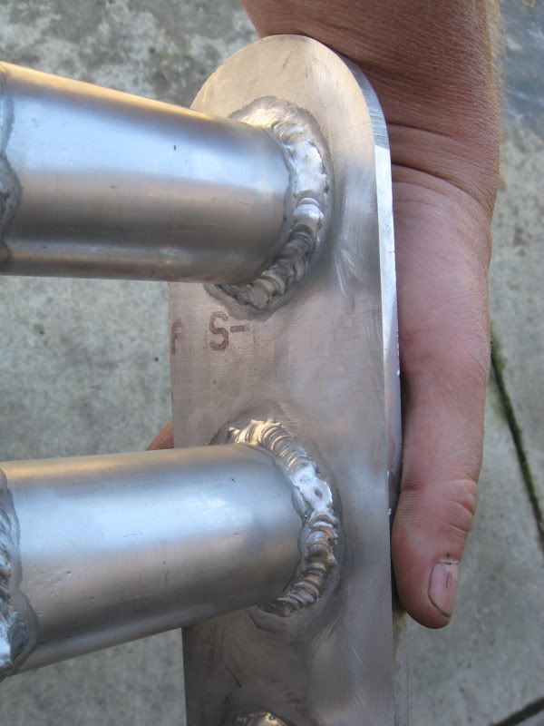

    Take one 318 intake manifold and chop most of it off, weld some .125 wall 2 inch tubing to it and you get this,

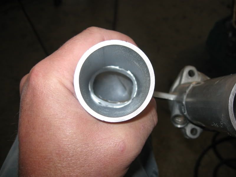

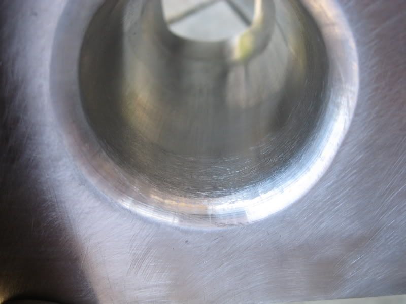

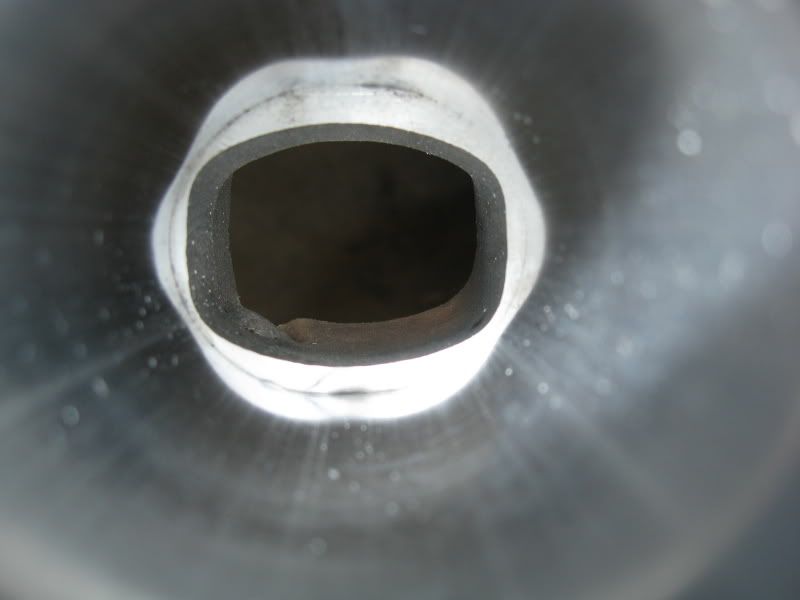

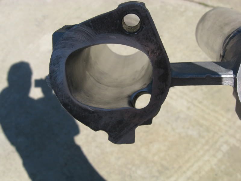

    Now it's a little oversize for the ports,
    So you have to do a little porting, rough,
    As good as I'm going to make it,
    Here is that part sitting on a junk head that I used for welding up my turbo manifold, looks like a straight shot to me. :-)

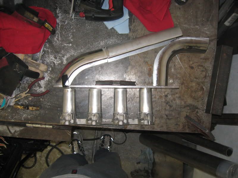

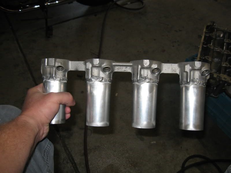

    Got a few more pieces cut out and placed them on the bench so you can kinda see where this is going,
    More tomorrow.

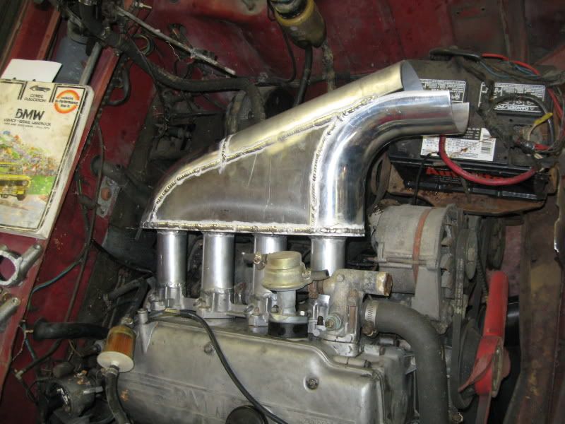

                  I got some more done yesterday, not as much as I would have liked but progress none the less.
                  Got the plenum bottom welded on, not the greatest welds but I don't do this for a living, it's just a hobby.
                  Here's what the look like from the other side, I used my router to make the radius.
                  I also got part of the plenum set in place, need to cut the flat parts and get them in and then make a cone for the throttle body section and bolt it on my other project ( 1600 ) to get the TB pointing correctly.
                  House work today so no more till Saturday.

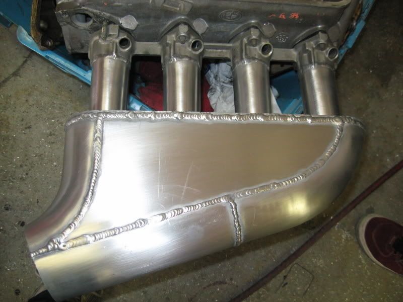

                          Made a little more progress today, had my buddy Cameron come over and help me with my welding a bit ( he's quite a bit better than I am and the tips came in handy )
                          Sitting in the 1600 bay for a fitment check ( the next project if I ever have money for it )
                          The rough end trimmed off and sitting on the junk head again,
                          I need to get the new double intercooler setup made for my 75 ( the daily ) so I can get the thottle body piece set exactly where I need it, I should be able to get to that next week. This is taking a bit more time than I expected but it's all good.

                            Those welds look pretty good! Welding thin-wall aluminum isn't easy.
                            • blueapplesoda
                              • Dec 2005
                              • 1904
                              No it isnt. Very nice work dude!
