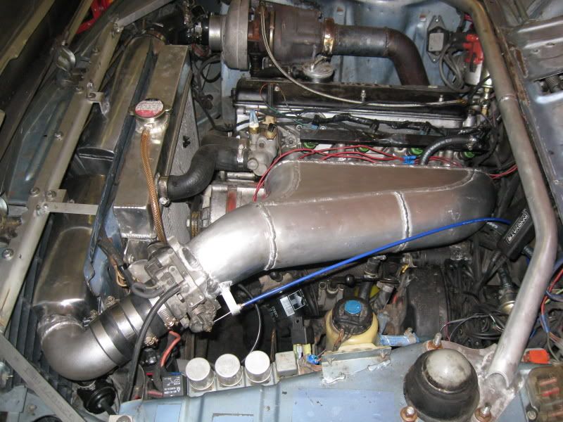

I like making stuff ( short runner intake ) for the deuce

          That looks awsome can I get one for an M52?
            Looks great mate! Very similar to the 666fab M42 manifold.

                I know it's a little late, but do can you, or anyone you know, run a CFD analysis of your design?
                In a Zcar forum I participate in, one guy ran an analysis on a similar design and it had a huge swirl in the center leaning out 2 cylinders quite dangerously.

                    Finally got it done, needs a bunch of cleanup work but it's in and runs ( hey it's my daily).
                      Nice job! Maybe you should teach me how to do that so I can make a "draft" version for the b35 lol
                      Are you still using the same throttle body or did you switch to something else with your adapter plate?

                        Same 57mm one off the Honda Prelude.
                          I can run it in SW floworks if given the specifications. Partially dividing the plenum may not be a terrible idea. It can be hard to simulate the discrete nature of the actual cylinders sucking air, though.

                            I wonder what the resonant frequency of the system will be. All you need to know is chamber volume, runner length and runner area and the sum is simple from there.
                            I do like the work and I hope it does what you want.
                              That looks really nice!!! Notice a difference in power?

                                wicked!! nice job on the fab! i am very curious to see what it flows
