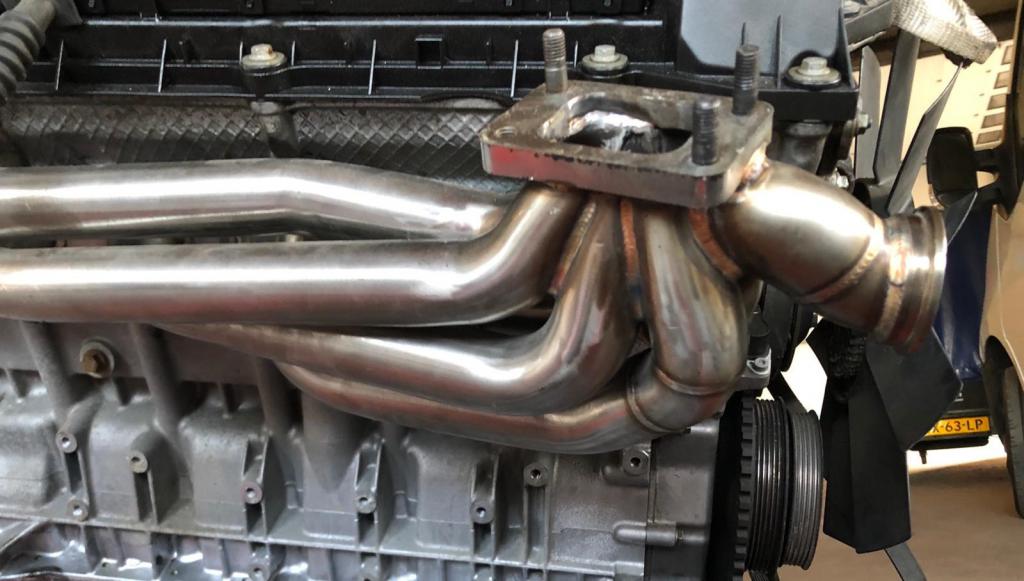

          In the meantime I purchased the turbo manifold below. Could you or anyone tell me which one this is? There is no label or part number on it at all. However, the quality of the manifold like the welding and finishing does look quite good and not Chinese crap.
          I found this one by accident for sale in combination with a HX35 and M52B28 (which I can use as spare engine or sell it) for a price I couldn't resist. Did all the measurements in my E30 M52B28 and it looks like it should just fit below the engine bay cover. It will be tight, but will see this next month when I will start on the turbo installation.
          Click image for larger version  Name:	M52_Turbo_Manifold_1.jpg Views:	0 Size:	63.8 KB ID:	9930140

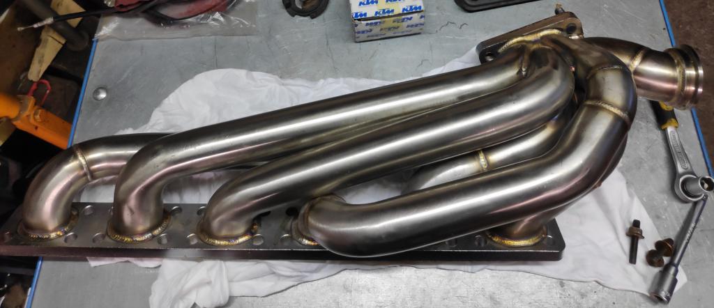

          I think my manifold is also having this as you can see. The wastegate opening on the manifold is ending in the front wherefore I do need a 180deg tube to route the wastegate to the exhaust side after turbo. Or aren't you meaning this?
          Click image for larger version  Name:	image_151843.jpg Views:	4 Size:	79.7 KB ID:	9930139
                  I'm not sure who makes that one, but if it fits the car, and the turbo oil drain/compressor housing/wastegate don't clash, I'd probably run it like that.
                  You might be able to tie into the rest of the exhaust from the wastegate by running it under the exhaust manifold? It might end up being decent routing. I think my biggest worry is the wastegate/turbo/drain clearance.
                    Can't also find any info on the manifold. Maybe some luck later.
                    Did not measured yet the clearance from manifold wastegate opening - front engine bay, but I think a wastegate and 180deg tube should just fit. And from there I am planning to run the rest under the exhaust manifold where it should join the downpipe somewhere again as you said.
                    Hope it will all fit and no other manifold is needed, but this I will see end of July. If someone in the meantime recognizes mine manifold so I have some more information about it, please let me know.
