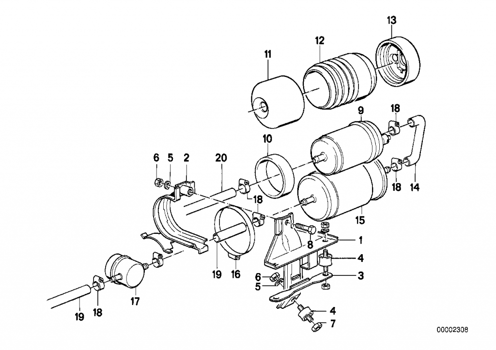

                  '87 likely has a second pump. I think the fuel pump setup change coincides with the physical fuel tank change, so if you remember an "S" pipe between both sides of the (early style) fuel tank, it probably has a second pump at the filter.
                  Something like this:
