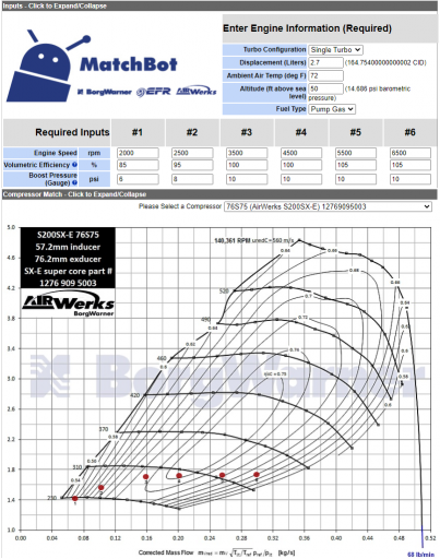

        While we're on the topic of BW turbos, I'm finally ready to pull the trigger on a turbo for my car. This is my first turbo build/car and I'm a little overwhelmed with options.
        The car will be controlled with my DIY MS2. It currently has a stock m20b25, which I don't expect to last long. The replacement engine currently being built will use an m20 block (decked ~2mm), seta crank and rods, b25 pistons, and b25 head with a mild cam. It'll be a 2.7 liter engine with about 9.4:1 compression. My goal is a fun streetable/auto-x car that spools quick and makes ~250-350whp. I plan to start with low boost and work my way up as I learn.
        A friend recommended I go with a BorgWarner S257 SX-E, .63 A/R T3 Open Inlet and 3.625" V-Band Outlet. It seems like this is a good selection for anything from 10-25psi on a 2.7L engine.
        Any thoughts/suggestions so I can make the right choice the first time?

          I don't know how knock limited an M20 is in boost (I mean people make 400 easily on stock CR), but bumping the CR up 0.6 of a point might cause issues as you up the boost unless you're running E85.
          .63 AR should give you a good usable powerband, but the s257 is maybe a little large if you're looking for 350 max?
