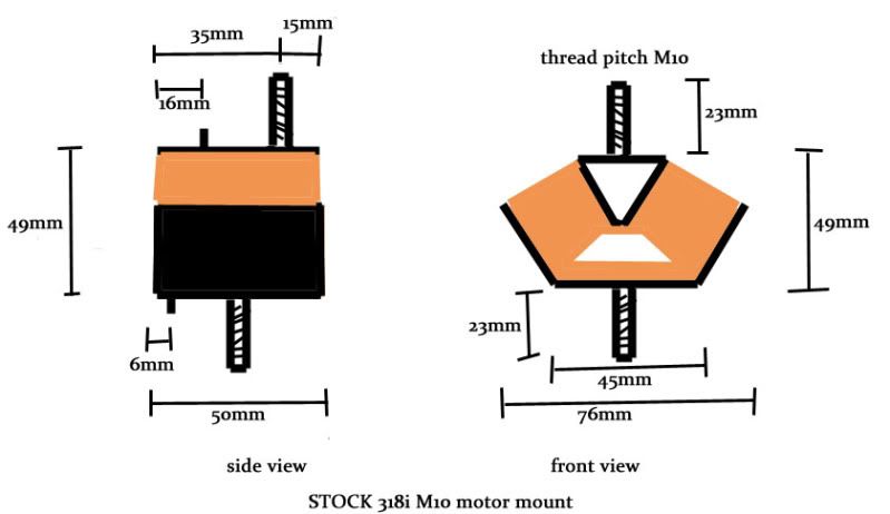

                      got a stock motor mount and made a diagram.....

                        Originally posted by irish44j
                        I wonder if he does urethane mounts. No interest here in solid mounts. M10 doesn't torque over enough to justify the NVH...I don't think it would be much of a performance advantage over poly.
                        If you get some specs I would love to send them his way. I want some better mounts.
                          look at the post above yours, lol.
                              Lol stupid phone of mine. Poly or NVH, I need something stiffer.
                              I may just cut some of the rubber section out of mine and then fill it with liquid poly, let it cure, and see how it does. we'll see.
