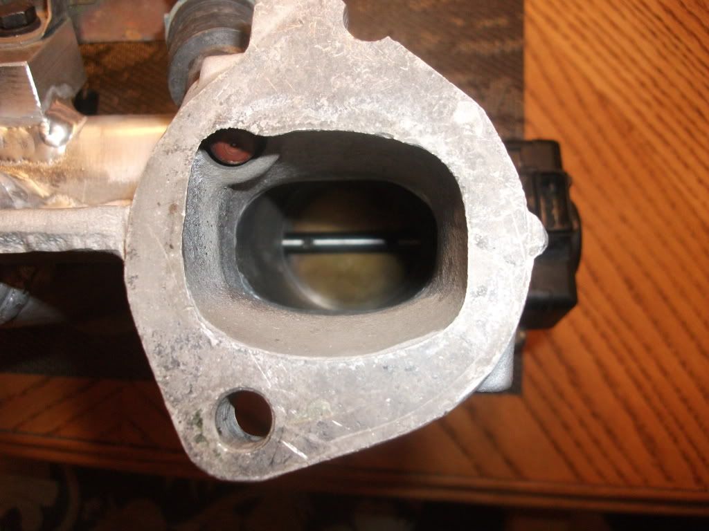

                    Once you cut off the flange on the s14 throttles the runner shape is an excellent match to the m10 flange. Which isn't really round(ish) at all. Here is a picture of how good of a match they are.
                    Not to mention the many other advantages that a set of s14 throttles have in comparison to using something from a bike or another manufacturer. The fact that they already have a throttle linkage designed to work in our chassis, meaning you won't have to fabricate your own. The built in provisions for an ICV and TPS. And lets not forget that the center to center spacing of the ports is the same as an m10.
                    Retro-fitting ITB's is no simple task. However I doubt you will find anything that can be fitted to an m10 more easily than s14 throttles.
