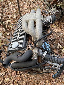

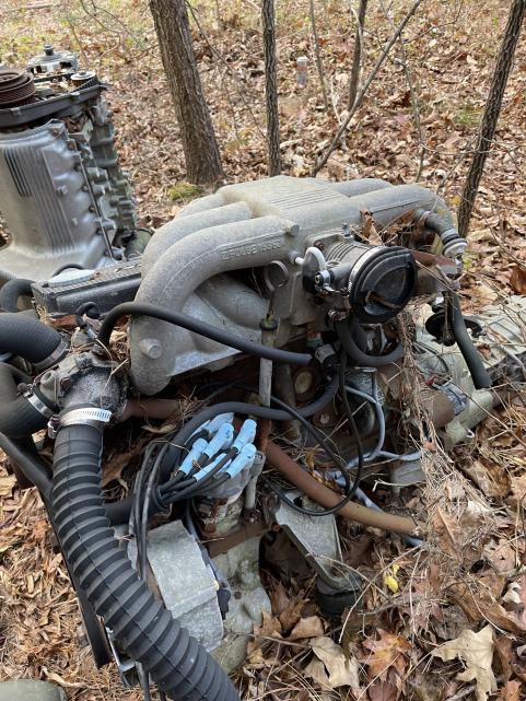

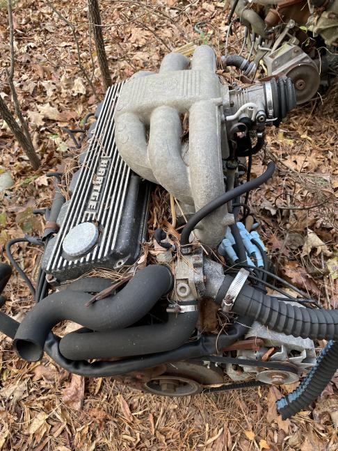

ID:	10038186 Anybody recognize this engine and what year and model bmw it may have come out of?

    my guess from an e21 H3 or 323i with Hartge valve cover
    • e30m3s54turbo
      • Jun 2010
      • 3292
      If it has a Hartge stamp on head next to thermostat itshould say H3 is 180hp or H23 170hp.
      • e30austin
        • 15382
        definitely out of an e21.

          Thanks for the responses. I will check today for any Hartge stamps or numbering. Any ideas of where to start to see if the engine is salvageable. I'm guessing turn the crank to see if it is locked up as a first step.
          • roguetoaster
            Biggus Tippus
            • 7830
            It's going to need a full rebuild if it's been outside of any period of time. If it's a Hartge modified head it may be worth working on, but the cam is probably a write off. See if it has any other Hartge marked parts such as the distributor or maybe the AFM if it's around somewhere. The transmission is probably a dogleg too if it's a Hartge package.
