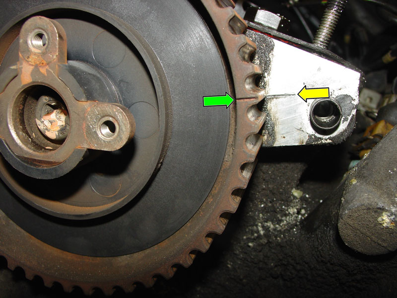

    Cool car, congrats!! There ia not much adjustment you can do. Cam timing is not adjustable. Is there a lot of wear on the cam? Post some pictures of cam lobes. I'd definetely put the check the cam for wear before doing anything. What spec camshaft does iH26 have?
    Here is a quick vid on the distributor. https://www.youtube.com/watch?v=UsDegs_TqoQ Video doesn't show the 3rd timing mark on the camshaft sprocket. There is a mark on the sprocket that has to be aligned with the mark on the head. Do all 3 marks line up well on your car?
