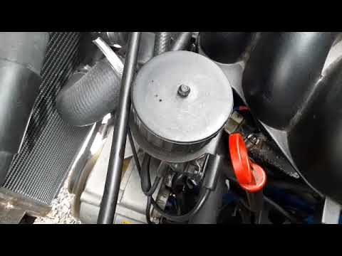

      Alternator? Waterpump? Video may distort the audio of course.
      • turbski
        • Jul 2018
        • 329
        Alternator is disconnected for that video for troubleshooting.
        inclined minds think alike lol
        • turbski
          • Jul 2018
          • 329
          Sorry the other video had alternator un hooked. That one had it hooked up. Same result either way
          • turbski
            • Jul 2018
            • 329
            I think I found the problem. In an earlier post I stated cam gear was loose. I pulled timing cover and set it aside.... never looked at it. Also found the lower timing cover loose.
            I happened to bump the upper cover off my bench. It hit the ground face down and showed me the inside..... completely chewed up from the belt walking forward. Same with the lower cover..
