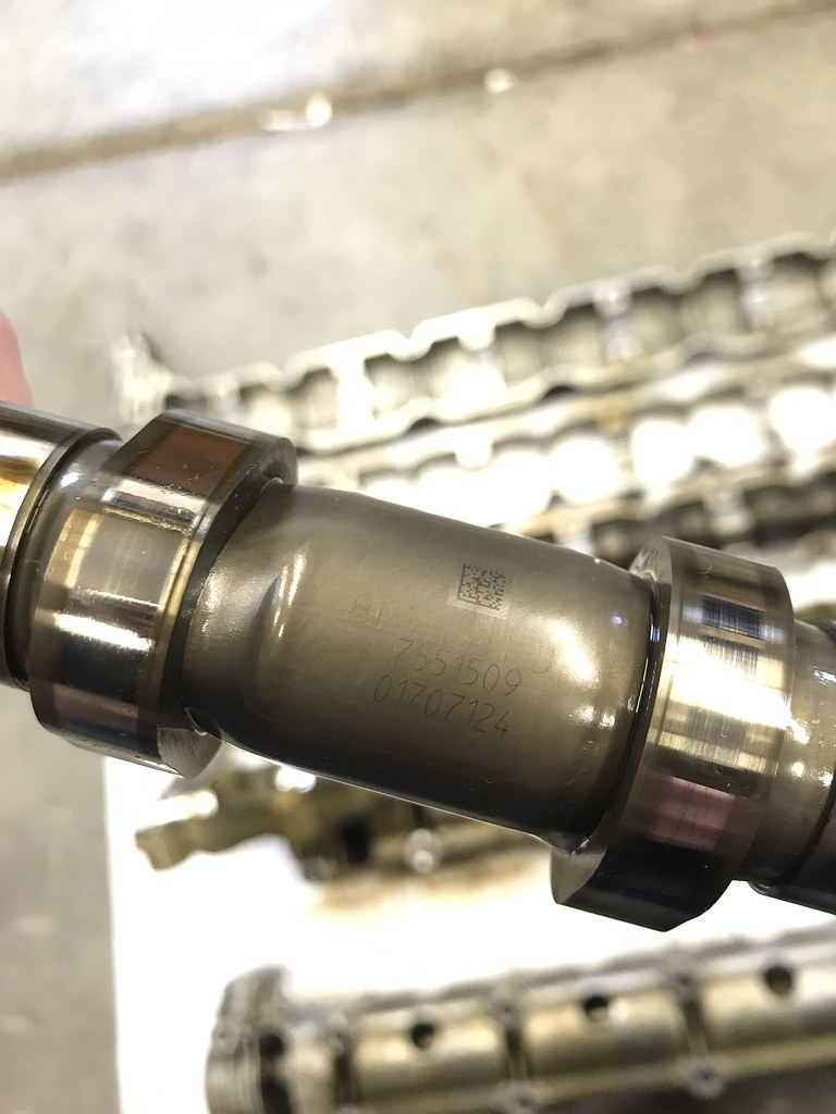

                    BMW even makes modern camshafts using a similar phenomenon.
                    It inserts a pipe into a die and pushes oil inside of the pipe. The pipe expands and takes the shape of the die.
                              Thats interesting.. Thats probably a ton of PSI of fluid pressure! Now i wouldn't call a radiator stout, but I'd expect a blockage to clear before the deformation seen here..
