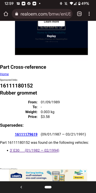

                              I located this rubber grommet for the fuel tank, my car however is a 7/87, it doesn't seem this sku coordinates with my month/year, it seems it is for the later and larger fuel tank
                              Attached is from RealOEM and here is it for sale:
                              https://www.fcpeuro.com/products/bmw...180152#fitment
